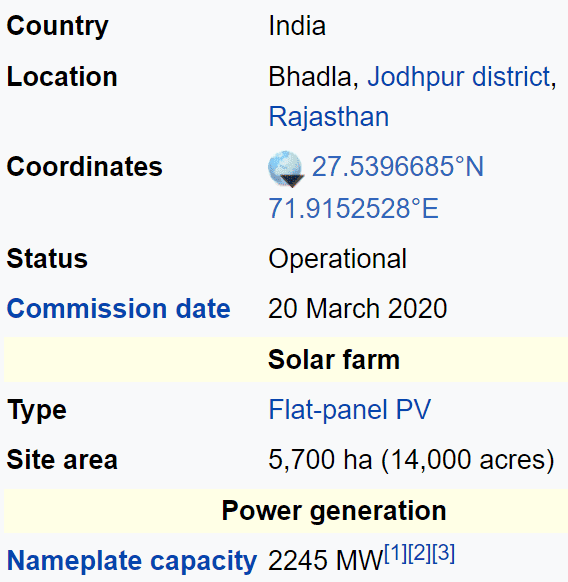

Cool, that is currently the worlds largest solar installation, not quite as cheap as 3 cents, as it was built in phases and the older installs reflect solar costs during the 2016-2018 installation
There is a 5000 MW project underway, and in total India has plans for 17.5GW across 15 'Ultra Mega Solar Parks' (the gov name for the program)
https://en.wikipedia.org/wiki/Ultra_Mega_Solar_Power_Projects
