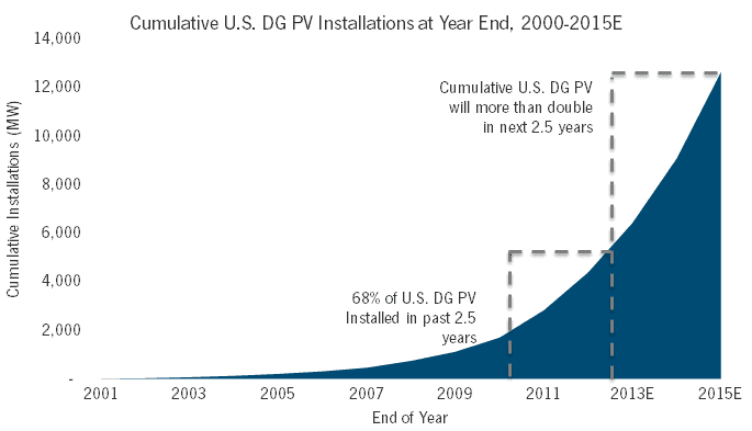

It seems to me that the real omission here is the basis for the claims about solar power.
If anybody doubts that federal energy regulators are aware of the rapidly changing electricity landscape, they should talk to Jon Wellinghoff, chairman of the Federal Energy Regulatory Commission (FERC).
Solar is growing so fast it is going to overtake everything,” Wellinghoff told GTM last week in a sideline conversation at the National Clean Energy Summit in Las Vegas.
...It could double every two years," he said.
Indeed, as GTM Research's MJ Shiao recently pointed out, in the next 2 1/2 years the U.S. will double its entire cumulative capacity of distributed solar -- repeating in the span of a few short years what it originally took four decades to deploy.
...“Solar PV is $0.70 or $0.80 per watt to manufacture. Residential rooftop is $4 to $5 per watt. But they are going to drive that down to $2 and then to $1 per watt.” ...
http://www.greentechmedia.com/artic...es-a-solar-future-and-a-utility-of-the-future

Though solar could certainly double twice in the next five years - which would just get it over 1% of our electric energy production - speculating beyond that is foolish and the official projections do not agree with that official. That sort of rate is very tough to sustain. And if it does sustain for 10 or 15 years, then solar becomes relevant and with it, its problems become relevant. IE, today, solar is such a small component of our energy production that it's extremely low capacity factor and near 100% variability (it produces near nothing at night or during bad weather) can safely be ignored. But once it gets to perhaps 5 or 10%, then it starts needing a backup: in essence, every solar plant will have to have a natural gas plant of equivalent power capacity built next to it.
The natural gas boom is a great temporary fix for the failing nuclear industry and any increasing demand due to the addition of hybrid or fully electric autos that use grid power , for example. But unless the concerns about climate change magically disappear, the natural gas gold rush is only a temporary reprieve.
I'm not sure that you read my post: nuclear power production hasn't dropped. And you have the relationships wrong:
