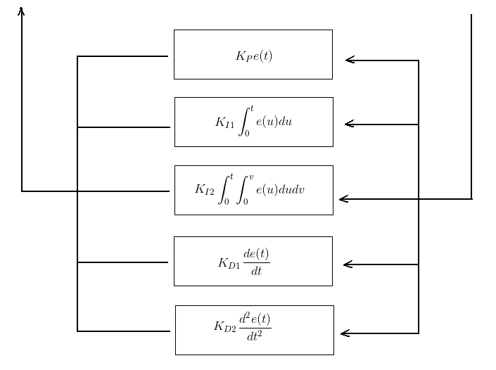

If the process you want to control can be described by a differential equation of order n, using a controller of order > n can create instability, limit cycles in a nonlinear system, etc.
Most of the differential equations in physics are of order 1 or 2, so there is not much practical use for higher order controllers.

This: (http://upload.wikimedia.org/wikipedia/commons/9/91/PID_en_updated_feedback.svg) is a comum PID. I'm proposing a PID like this:
Block diagram of a higher-order PID controller with five parallel gain blocks: K_P e(t), K_I1 integral of e(u) du from 0 to t, K_I2 double integral of e(u) du dv, K_D1 de(t)/dt, and K_D2 d²e(t)/dt², all fed the error signal e(t).
This system isn't a system of high order, or it is?
You can propose anything you like. I already told you why there is not much practical use for it.
