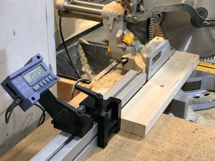

I am making this device :
https://www.proscale.com/media/cata...35074d0bca43668fbd9926d/1/7/17-06-27-005.jpeg
But with a motor, a pulley and a timing belt to move the carriage at the desired position. The position is measured via the rotary encoder that is linked to the second pulley (the free one). The aim is to have millimeter precision, to cut different bars length pretty fast. It would be a real upgarde in my work.
The system is already working, or near to work. I just need to tune my PID gains. But they are not bad for the moment.
As an opportunity to learn, or in case a change my linear rails so the frictions coefficients change, I would like to simulate the system, to be able to tune the PID gains easily. And finally to run a simulation loop with a genetic algorithm to find the best PID gains. I have already use genetic algorithm with other things. I just need to have the mathematical model of the system to go forward.
As I build other motorized things with closed loop as personnel hobby, those knowledge would be really interesting to have for me.
Is it more understandable?

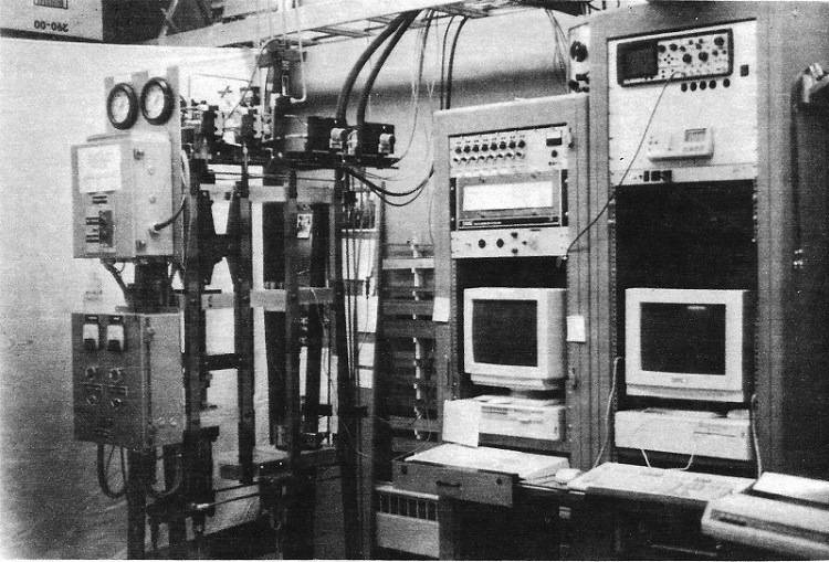

A photo of that test machine:

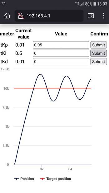

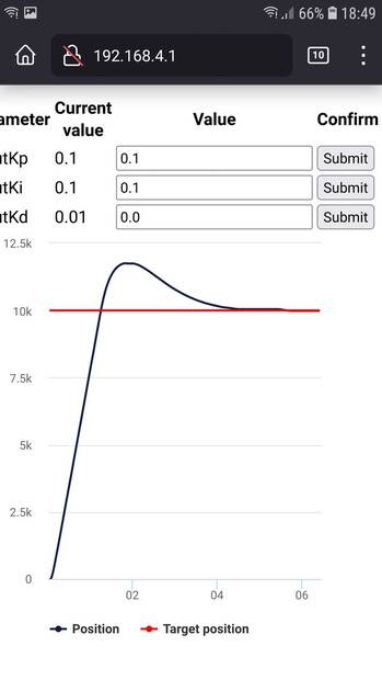

Currently, with my PID controller running, the step response graph looks like a second order system. Here is what it looks like with different PID gains. The Y-axis is not in mm, but in rotary encoder pulsation. The X-axis is in seconds :
I will measure and make a graph from a P controller with a P gain = 1 only, to see what the curve looks like.Do you think it could be possible to get the parameters of my system from a more precise graph and measured data?
