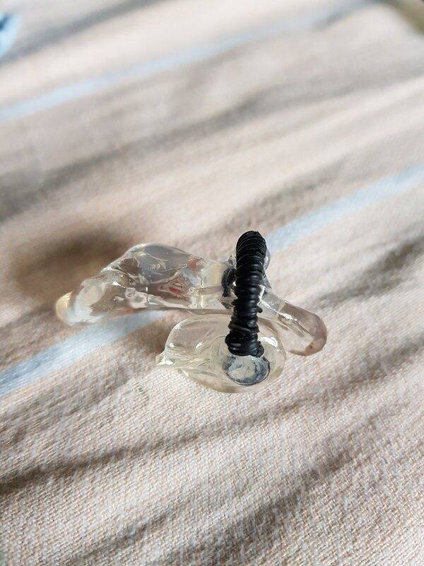

None of the above. I just wonder what are these ear molds materials made of and whether it can harm babies. These products are mostly made in USA and most other countries don't have them.
The best some can make are acrylic ear molds or one from molding plastic.

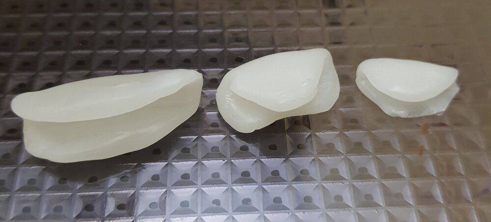

Outside the US. They don't make ear molds for 0 to 2 month old infant. I let a hearing aid fabricator create an ear mold for lop ears (where the helix is folded at the top). They haven't done it before. Not only is the shape wrong but the spring or connection is wrongly placed. It is acrylic. They only use acrylic or silicone for ears.
This is the original made by doctors in US.
Anyone know where to buy similar spring?
I tried to make one using polycaprolactone but its difficult to create exact shape.
Modify a spring from eBay, search for; 'fake-piercing spring'
Making the ear moulds is a job for a 3D printer.
Measure the dimensions with curved radius gauges cut from sheet material.
