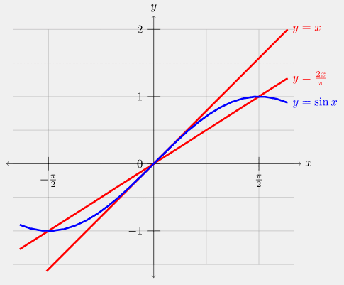

Alternatively, how about using these function graphs?

The derivative of sin in ##~0<x<\pi/2~## is ##~\sin'\,x<1~## but smaller, in part of the domain, than ##~\frac{2x}{\pi}##.

Let's start with ##x \overset ?> \sin x##.
The derivative indeed identifies the rate of change of the function, also called slope.
Initially, at x=0, both sides of the inequality are 0 (which is outside of the interval, so the inequality can still hold).
And indeed, for the right side of the inequality we have ##0 < \sin' x = \cos x < 1## on our interval.
Which rate of change do we have on the left side of the inequality?
Does it tell us how it compares?
The slope of 2x/π is 2/π=0.64
cos x varies between 0 and 1
Yes. So zooming in on ##x \overset ?> \sin x##, we know that the right hand side has a slope between 0 and 1.
What is the slope of the left hand side?
We'll get to ##\sin x > \frac{2x}\pi## later.
$$x'=1\geqslant \sin'\,x$$
So the slope of sin is smaller than the slope of x, so what does it say?
Maybe: they both start from 0 and since the slope of sin is smaller, it says sin(x) is under x?
Yep. That's exactly it. Since they start from the same value, the one with the lower slope must be below the other.
For ##\sin x > \frac{2x}\pi## we will need to look a bit further to the second derivative though.

We have a second derivative that is negative everywhere on our interval.
It means that the slope, which is positive everywhere, is decreasing.
That means in turn that the function value is everywhere above the line ##y=\frac{2x}\pi## as we can see in the function graph.
The slope of sin is bigger, so sin starts to shoot above 2x/π, but the slope is decreasing, so maybe the function itself goes down and under 2x/π.
I see from the graph that that isn't so, but can we deduce from the second derivative that it can't be?
y=2x/pi begins and ends on the graph of the sine. That is, for x=pi/2 its value is 1. And because the 2nd derivative is negative, sine is rounded upwards, putting it above the line.
So because there aren't any other points, apart of the beginning and ending, that sin and 2x/π equal, and because of the second derivative, you deduce that sin is above, right?
Yep
