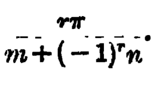

Solve the equation : ##\sin m\theta + \sin n\theta = 0##

Book's answer : Maybe I am right, but have a look at the answer I paste from the book on the right. I rewrite it here for better reading : ##\boxed{\mathbf{\theta = \frac{r\pi}{m+(-1)^r n}}}##.
I am assuming that (according to the book) ##r \in \mathbb{Z}##. Hence if I begin with ##r = 1##, I should have as an answer ##\theta = \frac{\pi}{m-n}##! When I substitute this answer in the displayed equation above, which is the same as the given problem written as a product of a sin and a cosise term, I find that it holds! The book is correct. Yet this solution is not one that I found - note that I only have answers as multiples of ##4\pi## for the case where the demonimator is ##m-n##.

Book's answer : The book gives the answer as $$\boxed{\mathbf{\theta = \frac{r\pi}{m+(-1)^r n}}}$$ We can verify that the list of values of ##\theta## from the book matches those of mine above, were one to write them out for various values of ##r \in \mathbb{Z}##. ##\mathbf{\huge{\checkmark}}##
A doubt lingers.
I obtained my solutions as ##\boxed{\theta = \frac{2k\pi}{m+n}}## and ##\boxed{\theta = \frac{(4l\pm 1)}{m-n} \pi}##.
The book writes them both in a compact form : $$\boxed{\mathbf{\theta = \frac{r\pi}{m+(-1)^r n}}}$$
Can you help me reduce my two-storeyed answer into the (nicer) form of that of the book?

The book's answer for r odd corresponds to your set of solutions in blue, and for r even corresponds to your solutions in red. Won't that do?
It does help to realize that the set {##{4l\pm 1}##} is the same the set {##{2l+1}##}.
Yeah I also think you should write the cosine solutions as ##\frac{\pi}{2} +l\pi##, it reduces the number of cases you have to deal with.
Then it's easy to notice you have solutions of the form ##\frac{r\pi}{m\pm n}## for every r, and the only thing left is to figure out how to express the sign of n as a function of r. ##(-1)^r## or ##(-1)^{r+1}## are pretty common.
