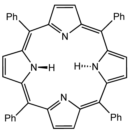

What is its polarity of a molecule of Tetraphenylporphyrin (TPP) as a whole?
2. The attempt at a solution
Given the structure of TPP, there is a ring inside that contains two N-H bonds across from each other and two nitrogen atoms with lone pairs across from each other like below:
N-H_____:N
R....R
N:_____H-N
As thus, I am to believe that these dipoles cancel each other out, leading to a molecule that is overall nonpolar. Can someone justify my argument?
It is a matter of symmetry. One way to look at it is as follows: the molecule has a centre of symmetry. A dipole is like a vector that points in a single direction. But you cannot have a dipole with this symmetry, because if you inverted the molecule through the centre of symmetry, the molecule would be exactly the same but the dipole would point in the opposite direction. That is a contradiction unless there is a zero dipole.
Your thinking and your argument was quite correct.
