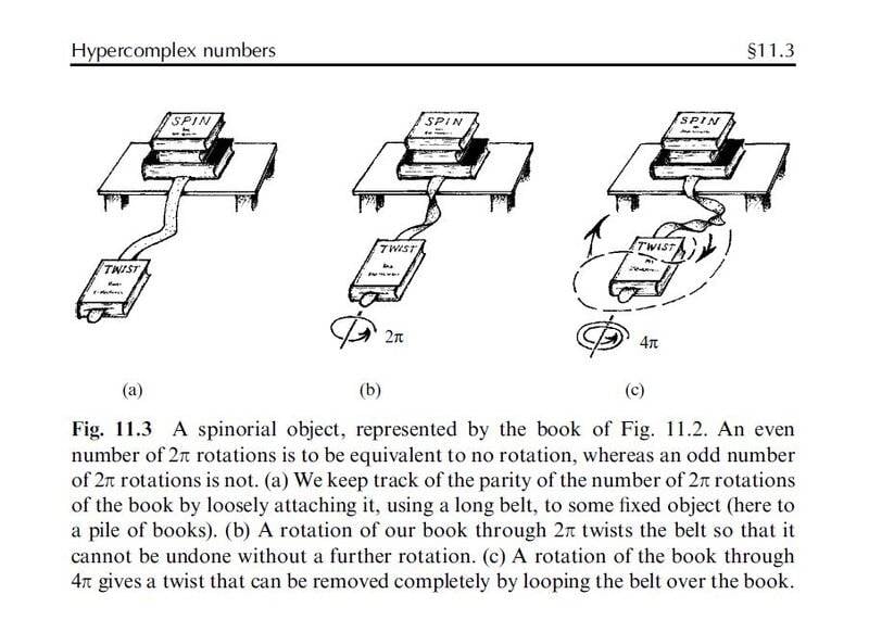

Hi, in the following video at 15:15 the twist of ##4\pi## along the ##x## red axis is "untwisted" through a continuous deformation of the path on the sphere 3D rotations space.
My concern is the following: keeping fixed the orientation in space of the start and the end of the belt, it seems there exist a continuous deformation of the belt taking place only in the ##x,y## plane that allows to untwist completely the belt.
Is it actually the case ? In other words my concern is whether the belt actually supports this kind of continuous deformation.
Ps. See also at 12:25 why the rotation path along the twisted belt takes place only in ##x,y## plane of sphere rotations space.

Take a look to the c) picture from Penrose's book
Simply loop the belt over the book !
Right, but I interpret "loop the belt over the book" as requiring the book be up so that the belt can go under it. I can't se how to get it to work otherwise.
I see in this video (not the one in the OP) that it is not necessary to circle anything around the stationary end (the book or her body in the video). It is only necessary to circle the rotated end around the belt (or hair in the video). So I will experiment more.
UPDATE: Sure enough. It works.
