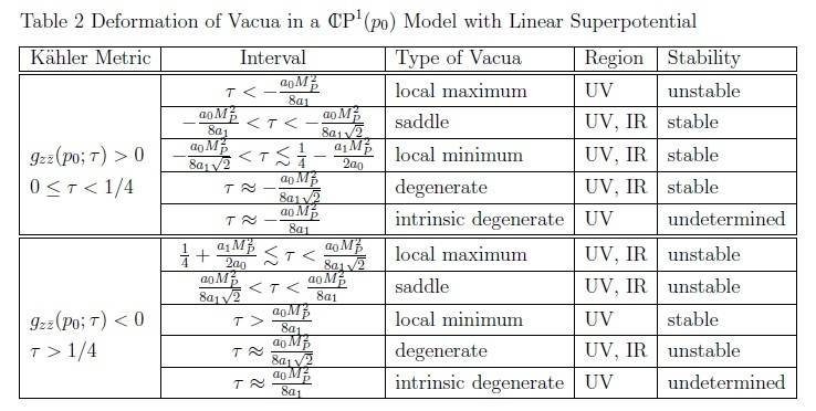

What is stability of Hawking Mass and how to calculate it? Any references will be appreciated. Thanks
What is "Hawking mass"? Do you have a reference for this term? It doesn't seem to be a standard term in physics.

I want to know what we talk about when we talk about stability of Hawking energy?
How can we know the Hawking energy is stable?
darida said:
Thank you so much for the references.
What do you mean by stability?
For example:
Source:
page 8
The above text refers to calculations done on the moduli space of a particular (lower dimensional) supergravity theory. The Hawking mass, is a *classical* quasi-local quantity.
Stability for the former, involves (amongst other things) seeing when the (super)potential goes negative (which would destabilize the quantum vacuum) or eg if it falls of a cliff, stability for the latter is going to require more input by you, b/c its not obvious what 'stability' means in that context mathematically (the quantity may readily be negative for instance).
