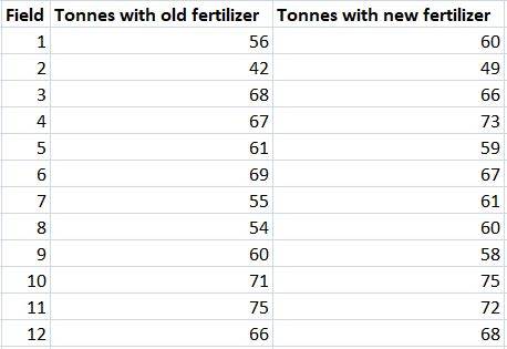

Hey! :o
In an effort to evaluate the quality of a new fertilizer we selected 12 fields which we split exactly in the middle. In the one half we used the old fertilizer and in the other half we used the new fertilizer. Then we measured in tonnes the crop that was harvested from each piece of land.
The results are in the following table:
  1. Should we use the dependent or the independent samples method to compare crops from the old and the new fertilizer?
  2. At significance level $a = 10\%$ can we say that the new fertilizer is more efficient than the old one?
  3. If we used the method of independent samples, what would we conclude? Compare the tests of questions 2 and 3.
I have done the following:
  1. The two samples are dependent since they come from the same fields. The fields with the most crop with the old fertilizer will probably have the most crop also with the new fertilizer.
    Is that correct? (Wondering)
  2. Do we calculate the mean value and define the null hypothesis and the alternativ hypothesis? Or how can we check that? (Wondering)

Hey mathmari!
Yep.
More specifically a paired dependent method. (Nod)

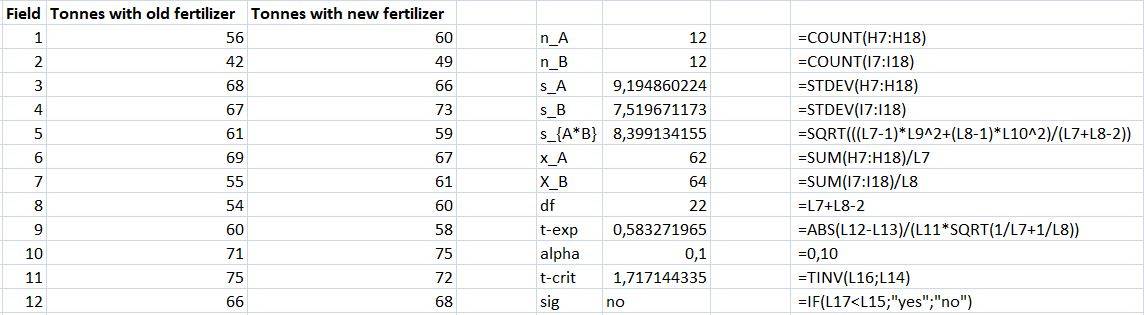

We have the following:
So since t-exp > t-crit is not true, we accept the null hypothesis.
Is everything correct? (Wondering) If yes, could you give me a hint for the question 3? Do we consider that the two fertilizers are not used in the same fields orhow do we consider the method of independent samples? (Wondering)

t-tests come in different variants, each with their own formulas.
Notably:
  • the 1-sample t-test,
  • the independent 2-sample t-test,
  • the dependent 2-sample t-test with unequal variances,
  • the dependent 2-sample t-test with equal variances,
  • the dependent paired t-test.
Since we have dependent pairs of measurements, shouldn't we do a dependent paired t-test? (Wondering)

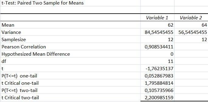

Ah ok! I used a command of Excel and I got the following:
Are these the values that we need? (Wondering)

I am not sure. Your values look as if you took a mean of each sample, but that would be wrong.
The proper evaluation is to consider a single sample that consists of the differences of each 'pair'.
Consequently we have a single sample of differences.
And we would compare its mean to '0', which is what we would have if 'there is no difference'. (Thinking)

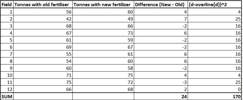

We have the following table:
We have the hypotheses: $H_0: \ \mu_d=0$ and $H_0: \ \mu_d\neq 0$.
We have that $\overline{d}=\frac{24}{12}=2$, $s_d=\sqrt{\frac{170}{12}}=3.76$.
The test statistic is \begin{equation*}t=\frac{\overline{d}-\mu_d}{\frac{s_d}{\sqrt{n}}}=\frac{2-0}{\frac{3.76}{\sqrt{12}}}=\frac{2-0}{\frac{3.76}{\sqrt{12}}}=1.84261\end{equation*}
For the degree of freedom, since we are testing $12$ values of difference, we have $df=12-1=11$.
Is everything correct so far? Now it is left to calculate the p-value, or not? (Wondering)

I have reread the question, which says:
2. At significance level a=10% can we say that the new fertilizer is more efficient than the old one?
It means that the alternative hypothesis should be $H_1:\,\mu_d > 0$. (Blush)

When we calculate a sample standard deviation, shouldn't we divide by $n-1=12-1$? (Worried)

After correction of $s_d$, the next step is indeed to calculate the p-value. (Nod)

Ahh ok! So we have the following:
We have the hypotheses: $H_0: \ \mu_d=0$ and $H_1: \ \mu_d> 0$.
We have that $\overline{d}=\frac{24}{12}=2$, $s_d=\sqrt{\frac{170}{12-1}}=\sqrt{\frac{170}{11}}=3.93$.
The test statistic is \begin{equation*}t=\frac{\overline{d}-\mu_d}{\frac{s_d}{\sqrt{n}}}=\frac{2-0}{\frac{3.93}{\sqrt{12}}}=\frac{2}{\frac{3.93}{\sqrt{12}}}=1.76290\end{equation*}
Using the R-program command "pt(1.76290,df=11, lower.tail=TRUE )" we get the p-value $0.9471801$.
We have that $\text{p-value} > \alpha$ and so we do not reject $H_0$, there is not enough evidence to show that the new fertilizer is more efficient than the old one.
That p-value does not look correct. A t-value of 1.76 should be more or less significant. I think we have the wrong formula in R. (Worried)

Ok. Now I tried it with Excel, I used the command [M]TDIST(ABS(1,7629);11;1)[/M] and I get $0.052819887$. Now we have that $\text{p-value} < \alpha$ and so we accept the null hypothesis.
That would mean that the new fertilizer has the same results as the old one, or not? (Wondering)

Nope. A high t-value implies that the means are far apart, doesn't it? (Worried)
What does it mean again that $p<\alpha$? (Wondering)
Oh yes, you're right. I confused that. (Tmi)
