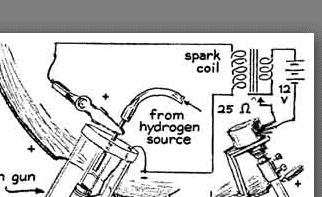

Hello,
I am working on a project that requires both high voltage AC and DC.
I was going to use an ignition coil for the AC because I thought it's output would be AC, but when I saw this illustration, https://www.google.ie/url?sa=i&rct=...cH4F28DNcL3AnRFD_vluFa7A&ust=1498033191615843 , I got confused. It shows the output to be DC.
If powered as is shown in the illustration, is it AC or DC?
Thanks ,
Max

I would expect it to be pulsed DC ... the pulses being produced by the points / CDI or what ever other system is utilisedDave

http://hyperphysics.phy-astr.gsu.edu/hbase/magnetic/ignition.html shows that yes, you should get unipolar pulses out of your coil . But it might 'ring' ie decaying sinusoidal oscillation , unlike the clean pulse in the hyperphysics images.
Your link redirects me to here - is that correct ?
http://www.sciencemadness.org/talk/files.php?pid=91557&aid=2775.
Is that a Model-T Ford spark coil ? Looks like it'd buzz and make continuous stream of pulses.
If your multiplier capacitively coupled(as in this wikipedia link) it won't mind the DC content at its input.
https://en.wikipedia.org/wiki/Cockcroft–Walton_generator
The CW is a voltage multiplier that converts AC or pulsing DC electrical power from a low voltage level to a higher DC voltage level.

Thanks for replying,
I got the schematic to power my coil from . Yes, the image in the link is what I was looking at. Is the video correct in sating that it gives AC output?
Thanks again,
Max

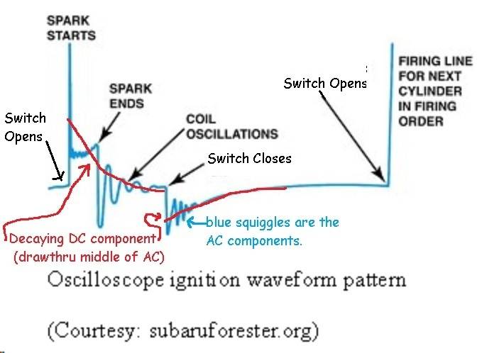

We always want simple answers. But Mother Nature makes us work harder than that before she gives us understanding.
Interrupting current through the coil initiates a spark. That's always one polarity.
The capacitor allows "ring down" which is AC.
Not trying to be obscure here, just precise.
It's a repeating transient waveform.
That transient waveform has two components - damped AC and decaying DC.
So your video is i would say oversimplified.
I think the truest answer is "Unipolar pulses with substantial AC components ".
old jim
