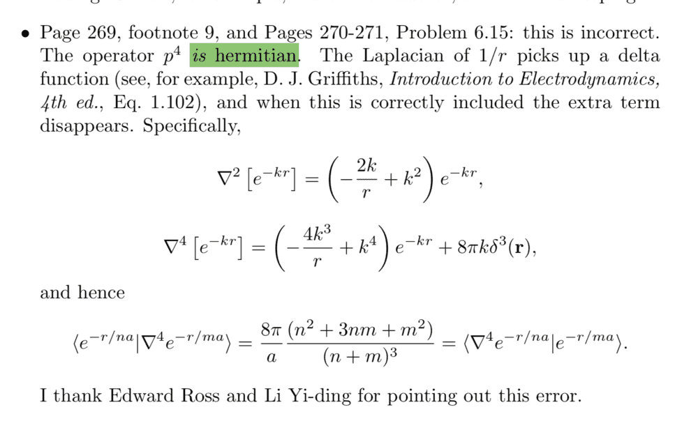

Happiness said:
Intro to QM, David Griffiths, p269
