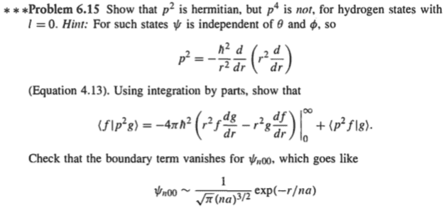

Why is ##p^4## not hermitian for hydrogen states with ##l=0## when ##p^2## is?
Doesn't this contradict the following theorem?
The product of two hermitian matrices, A and B, is hermitian if and only if they commute, AB=BA.

Intro to QM, David Griffiths, p269

He is saying ##p^2## is hermitian but ##p^4## is not for the same pair of states, f and g, both with ##l=0##.

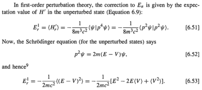

Mathematically we have: ##P^2## Hermitian ##\Longrightarrow \; P^4## Hermitian. So either he made a mistake, or ##P^2## isn't Hermitian in ##l=0## states, or ##P^4 \neq (P^2)^2##. I don't know what ##P^4## means, as ##P^2## doesn't look like a square either. What would be ##P## to get ##P^2= -\dfrac{\hbar^2}{r^2}\dfrac{d}{dr}\left( r^2\dfrac{d}{dr} \right)##?
##p## is the momentum operator as seen from [6.52].
##p^4=(p^2)^2## and ##p^2## is hermitian as seen from [6.51].

The question is: What is the value of ##\left.\left( r^2 f\dfrac{dg}{dr} - r^2g\dfrac{df}{dr} \right)\right|_0^\infty## for ##f=\psi_{n00}## and ##g=\psi_{m00}?##
For ##g=\psi_{100}## and ##f=\psi_{200}##,
##\left.\left( r^2 f\dfrac{dg}{dr} - r^2g\dfrac{df}{dr} \right)\right|_0^\infty=\left.\left(\frac{1}{8\sqrt{2}\pi a^5}r^3e^{-3r/2a}\right)\right|_0^\infty=0##, where ##a## is a constant.
