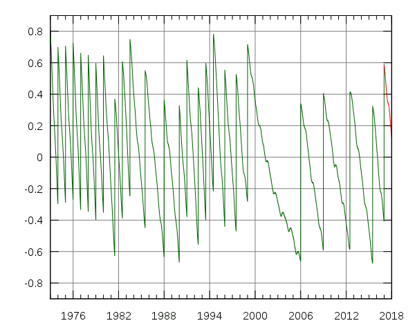

A nice little graph, courtesy Wikipedia:
This graph shows the difference between UT1 and UTC. The horizontal axis is in years. The vertical axis is DUT1=UT1-UTC (in seconds). If you spliced the ends of each descending section together you would get a graph of the difference between UT1 and Atomic Time (less a constant; TAI-UTC is presently 34 seconds). Subtract another 32.184 seconds and you get the additive inverse of Delta-T, the difference between Terrestrial Time and UT1. Ignoring those leap second discontinuities, the graph isn't a straight line.
