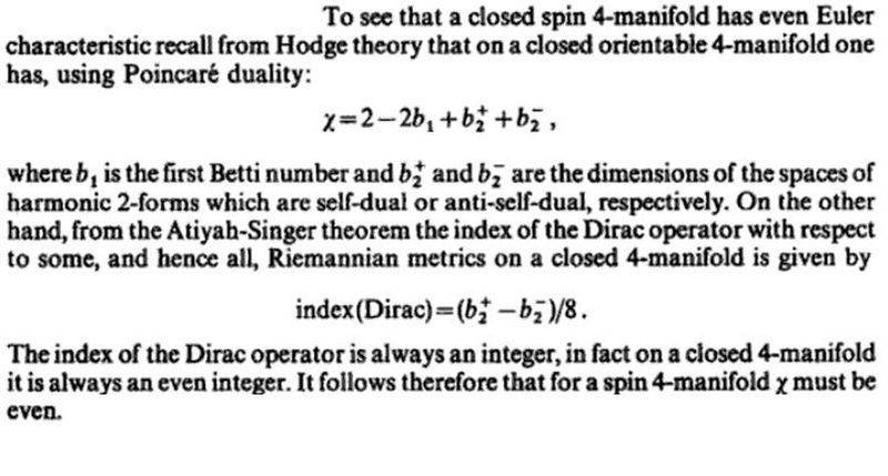

You may be right. Let me notice that by the Whitney embedding theorem every smooth n-manifold embeds smoothly in 2n-Euclidean space. So your second condition is superfluous.
Now, as your manifold is orientable with w2=0, it is a spin manifold. And that’s what i found in a book by Stephen Hawkins ‘himself’, a proof that every closed spin 4-manifold has even Euler characteristic - see attachment.
Thanks. I think you can get this result without the Atiyah-Singer Index theorem. The arguments I gave show that the manifold can not be embedded in R^8. But the Whitney Embedding Theorem says that any smooth closed 4 manifold can be embedded in R^8. Therefore the Euler characteristic must be even.
