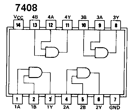

Is there a chip (be it 4000 series or 74XX series) that performs the following function? It basically takes in a binary string, and ANDs each part of the string with a certain control bit to produce a new binary string.
It seems that neither muxes nor demuxes serves my purpose. So I'd appreciate if anyone could suggest a chip that does this so I don't have to construct it.
http://img4.imageshack.us/img4/4087/cccnl.png
BiP
Is the string always going to be 4 bits?
If so you could use a 7408 and wire together 1 set of the input pins and then connect that to the control bit?
ie. from that diagram you could wire together pins 1, 4, 12 and 9 to be your control bit? or a different rearrangement if it was easier to solder together.
