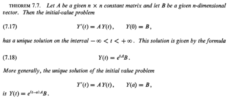

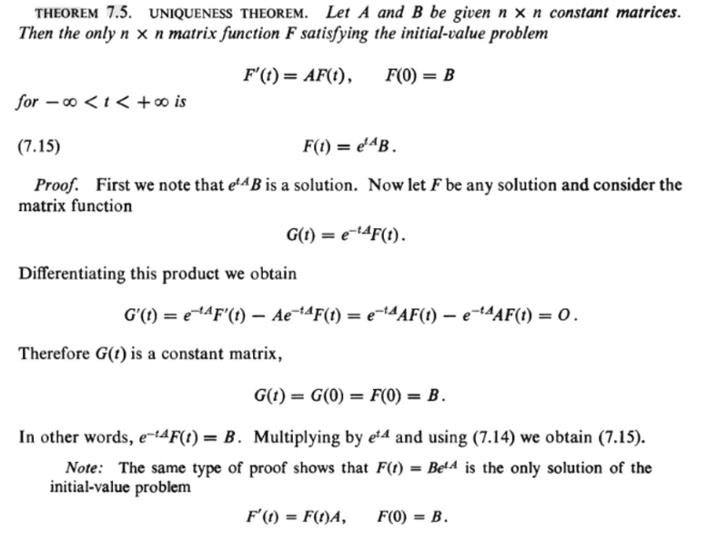

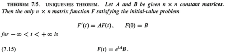

The theorem shown below appears in Apostol Vol II, Ch. 7 "Systems of Differential Equations".
It seems matrix ##B## should not be ##n\times n## but rather ##n\times 1##.
I mean, maybe there isn't a typo.
If ##B## is ##n\times n## then don't we have ##n## initial value problems?
##F(t)## is said to be ##n\times n##. Is not each column of ##F## a solution to one of the ##n## IVPs?

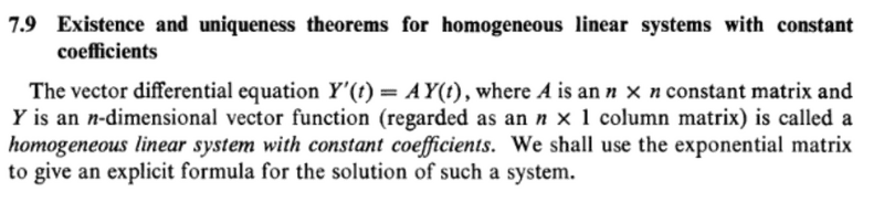

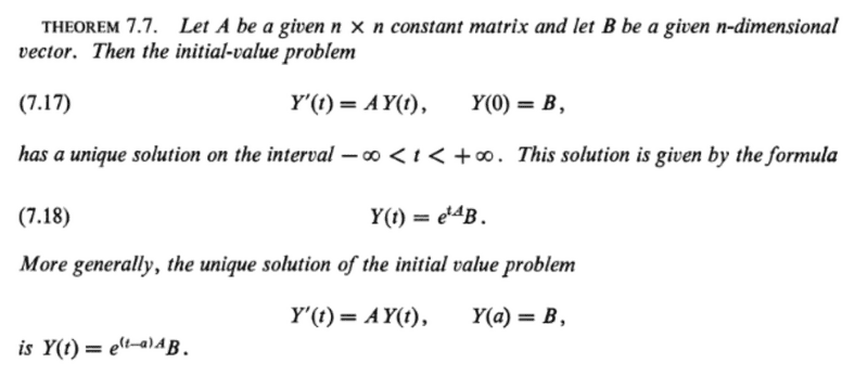

Just a little later in the book there is the following theorem
Now, ##B## is ##n\times 1## but the problem is also called an "initial value problem".
So, at a minimum, it seems the language used in the theorems is confusing. Is it also incorrect? How can ##B## have dimensions of either ##n\times n## or ##n\times 1## and either way the problem of ##Y'=AY## with ##Y(0)=B## is considered "an initial value problem".
It is no typo. ##A,B## are ##n\times n##-matrices. The function ##F(t)## is the parameterization of a curve through a space of these matrices.
I never really understood why there are these two separate theorems in the book.
It's a bit unfortunate to use the same letter ##B## for a matrix and a vector, but the principles are the same, only that ##F(t)## is a curve in a matrix space and ##Y(t)## is a curve in a vector space.

Ok, so ##A## is definitely ##n\times n##. Is ##F## ##n\times 1##?

So here they have a vector ##Y##. Was ##F## a vector or a matrix, previously, in ##F'=AF##?
Finally there is the theorem that I showed in the OP
##F## is no vector, it's a curve. E.g. ##F\, : \,[0,1]\longrightarrow \mathbb{M}(2,\mathbb{R})## defined by
F(t)=\begin{pmatrix}e^t&ct\\0&e^{-t}\end{pmatrix}
would be such a function, with ##F(0)=B=I.##

an initial value problem is any problem where the value of your desired solution is specified at t=0, the initial time. If your function is matrix valued, the initial value is a matrix, if it is vector valued, the initial value is a vector, if it is real valued, the initial value is a number. If you think everything should be a number, then to you, a vector valued initial value problem is n^2 initial values. One reason for introducing vectors and matrices is to be able to think of n numbers, or a square array of n^2 numbers, as one object. When I was a young student, it ws very challenging to me to have my book just write f(x), which meant sometimes a number and sometimes a vector, and sometimes a matrix. Your book is using B purposely for a matrix and for a vector because a vector is the special case of a column matrix. In theorem. 7.7 he wants you to remember that previously, in 7.5, the same letter B was a matrix, and you should realize this later result is a specialization of the earlier one.
I.e. Theorem. 7.7 is just a special case of theorem 7.5. It is stated separately because it is in this version that many books state the result. This shows you that the usual vector version is a special case of the general matrix version. They could also be stated in the other order, and one could then observe that the more common vector version has a generalization, with essentially the same proof, to a theorem about matrices. Other books only give the result for real valued functions, and then these are two further generalizations of that more elementary result, all with essentially the same proof. There is no doubt an infinite dimensional Banach space version, with the letters A and B representing linear transformations or elements of a Banach space. For this see Lang or Dieudonne'.

The original theorems 7.5 and 7.7, are almost trivial, as the proof in Apostol shows. I.e. existence, or the fact that e^tA solves u' = Au, is just a matter of knowing how to differentiate the exponential function. the uniqueness is the same argument used in beginning calculus, to show that the only functions with derivative zero are constants. I.e. assuming u' = au, look at h = u/e^at. By the quotient (or product) rule we get h' = [u'e^at - uae^at]/ e^2at = [aue^at-uae^at]/e^2at = 0. Hence h = constant c, so h = c.e^at. and c is determined by the initial condition.
But the question was why they are both stated separately, for which I stick with pedagogy, i.e. learning is facilitated by repetition, in particular it is useful to see how to specialize general statements. The OP is thus to be commended for seeing that the statements are in theory needlessly repetitious.

The way I would think about this, is 7.7 in some way implies 7.5, in that 7.7 is the normal initial value problem you are thinking about, and you can cast the 7.5 version as:
Given nxn matrices ##A## (fixed) and ##x## (arbitrary) the map ##x\to Ax## is linear. So there exists some ##n^2\times n^2## matrix ##A'## such that if you treat ##x## as a vector of length ##n^2##, you can rewrite ##Ax## as ##A'x##. Then you can solve the initial value problem ##y=A'x##, ##y(0)=B## with ##y=e^{A't}B##.
That's great but this thing we just computed is an ##n^2\times n^2## matrix. It's not obvious that ##e^{A't}## acting on ##n^2## length vectors is the same as ##e^{At}## acting on ##n\times n## matrices. It turns out it is I guess, but you have to think about how to show it
It's even easier than that. Think about how matrix multiplication is defined.
For [itex]\dot x = Ax[/itex], [itex]x[/itex] can be any size of matrix for which [itex]Ax[/itex] is defined and [itex]Ax[/itex] is the same size as [itex]x[/itex], ie. [itex]x[/itex] must be [itex]n \times m[/itex]. The [itex]k[/itex]th column of [itex]Ax[/itex] depends on each row of [itex]A[/itex] but only on the [itex]k[/itex]th column of [itex]x[/itex], so we are in effect solving [itex]m[/itex] independent initial value problems for an [itex]n \times 1[/itex] matrix.
For [itex]\dot x = xA[/itex], [itex]x[/itex] must be [itex]m \times n[/itex]. This time, the [itex]k[/itex]th row of [itex]xA[/itex] depends only on the [itex]k[/itex]th row of [itex]x[/itex], so we ae solving [itex]m[/itex] independent initial value problems for a [itex]1 \times n[/itex] matrix.
