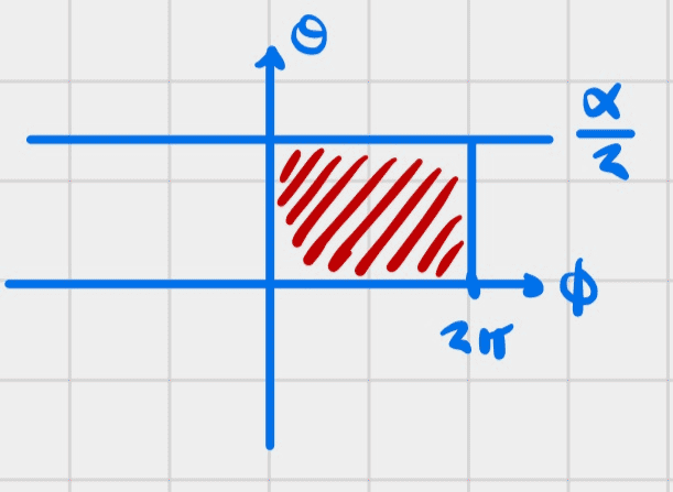

Using spherical coordinates, the cone is ##\theta=\alpha/2## and the sphere is ##\rho=a##.
The parameterized equation for the sphere is ##\vec{r}=\langle a\sin{\theta}\cos{\phi}, a\sin{\theta}\sin{\phi}a\cos{\theta}\rangle##.
The portion inside the cone is the red area below

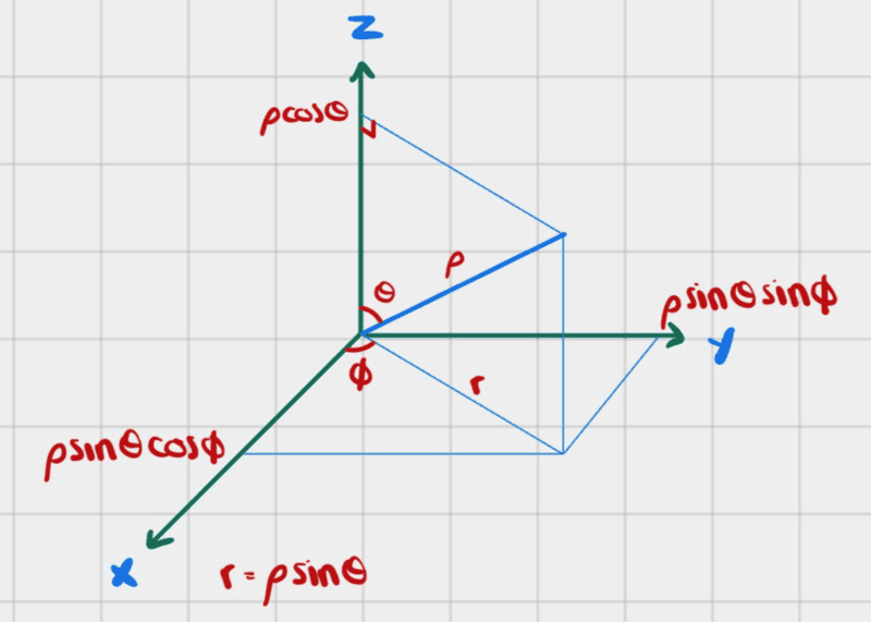

Just to be clear about the coordinate system, I am using spherical coordinates defined as follows

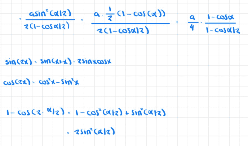

However, it seems that either I have made a mistake or the solutions manual is wrong, because they have the answer
On the axis of the cone, at a distance ##\frac{1}{4}a\frac{1-\cos{\alpha}}{1-\cos{(\alpha/2)}}## from the center of the sphere.
Are you familiar with the formula for the cosine of a double angle ##\cos(2x) = \ldots##?
Ah yes, that is indeed the solution to my woes.
I will say that your expression looks tidier. The given expression likely originated from using that ##\sin(\theta)\cos(\theta) = \sin(2\theta)/2## before integration.
