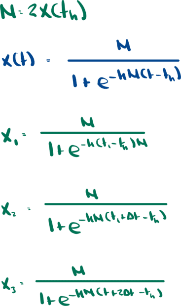

First I tried to just plug the values in
Handwritten equations: M = 2x(t_h); x(t) = M / (1 + e^(-kM(t - t_h))); then x_1, x_2 and x_3 each given by M / (1 + e^(-kM(t_1 - t_h))), M / (1 + e^(-kM(t_1 + Δt - t_h))) and M / (1 + e^(-kM(t_1 + 2Δt - t_h))).
But this doesn't seem to tell me much.

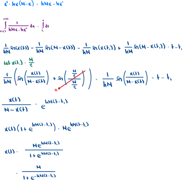

Well, I will post now, as I continue to think about this problem.Since it will be too much work to write out all my work for problem 13 in equations, here is a screenshot of the work
Handwritten derivation: x' = kx(M-x) integrated via partial fractions, giving ln(x/(M-x)) = kM(t - t1), solved to x(t) = M / (1 + e^(-kM(t-t1))), with a crossed-out substitution x(t1) = M/2.

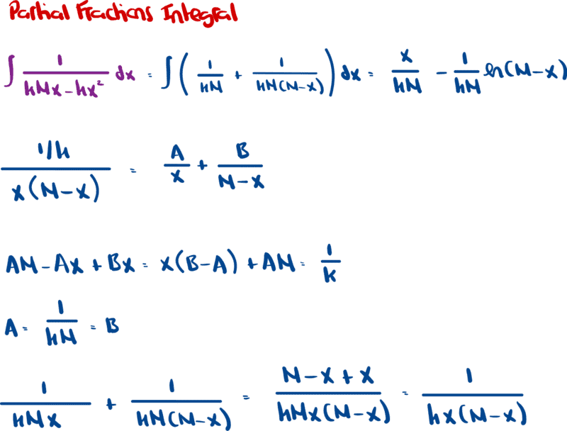

Note that I used partial fractions to solve the integral in purple, and the calculations were as follows
Handwritten partial fractions working: integral of 1/(hMx - hx^2) dx split as integral of (1/(hN) + 1/(hN(N-x))) dx, giving x/(hN) - (1/(hN)) ln(N-x); then 1/(h x(N-x)) = A/x + B/(N-x), leading to A = B = 1/(hN).
  • Handwritten derivation solving the logistic equation x' = kx(M - x): partial fractions integral, logarithm terms, substitution x(t1) = M/2 with a crossed-out term, leading to x(t) = M / (1 + e^(-kM(t - t1))).

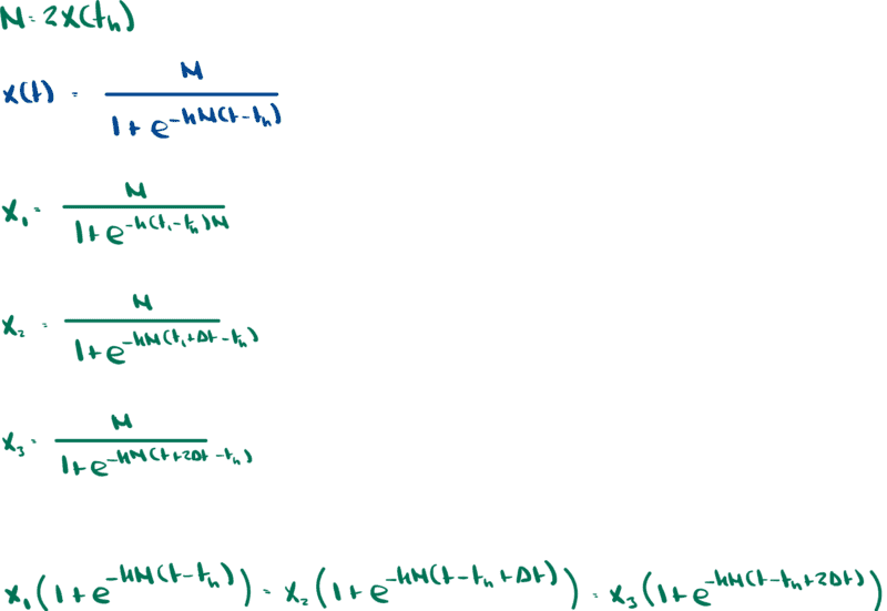

  • Handwritten derivation: N = 2x(t_h); x(t) = M / (1 + e^(-kM(t - t_h))); then x_1, x_2 and x_3 written as M over (1 + e^(-kM(t_1 - t_h))), M over (1 + e^(-kM(t_1 + Δt - t_h))) and M over (1 + e^(-kM(t_1 + 2Δt - t_h))); final line x_1(1 + e^(-kM(t - t_h))) = x_2(1 + e^(-kM(t - t_h + Δt))) = x_3(1 + e^(-kM(t - t_h + 2Δt))).

zenterix said:
First of all, a few observations
1) It is not clear if the ##t_1## used in problem 14 is the same ##t_1## from problem 13 where ##x(t_1)=\frac{M}{2}##.
It isn't, for the following reason:
However, if it were, then the problem seems like it wouldn't make too much sense because we'd have ##M=2x_1## and that'd be it (though this wouldn't match the expression the problem has for ##M##).
We would be able to solve for ##k## as well in this case with just one census reading.
2) From (8.23) it seems that the population never actually reaches ##M##. It just gets really close from below.
Now let me rewrite the equation for ##x## as follows
$$x(t)=\frac{M}{1+e^{-kM(t-t_h)}}$$
where now ##t_h## is such that ##x(t_h)=\frac{M}{2}##.
I've tried a few things but am a bit stuck.
The key is that the times are equally spaced, so [itex]t_2 = t_1 + T[/itex], [itex]t_3 = t_1 + 2T[/itex]. Then you have [tex]\begin{split}<br /> x_1 &= \frac{M}{1 + A} \\<br /> x_2 &= \frac{M}{1 + e^{-kM(t_1 + T - t_h)}} = \frac{M}{1 + AB} \\<br /> x_3 &= \frac{M}{1 + e^{-kM(t_1 + 2T - t_h)}} = \frac{M}{1 + AB^2} \end{split}[/tex] where [itex] A = e^{-kM(t_1 - t_h)}[/itex] and [itex]B = e^{-kMT}[/itex]. Here I think the strategy is to find an expression for [itex]B[/itex] from the second equation, and set the square of that equal to the expression for [itex]B^2[/itex] obtained from the third equation; then the first equation can be used to eliminate [itex]A[/itex].
