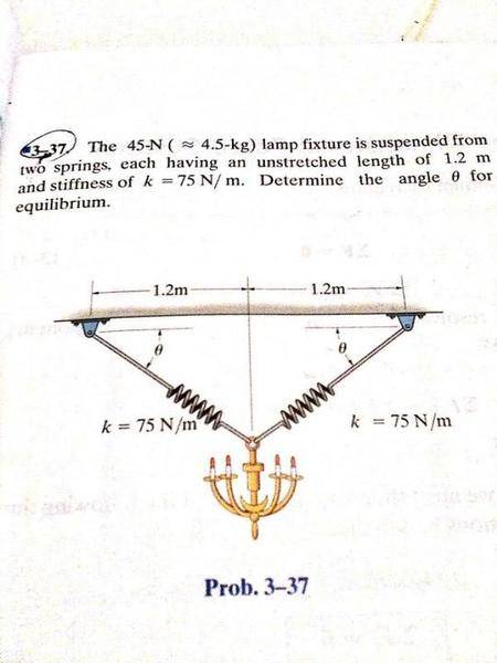

Is there an easier way to solve for theta in this equilibrium problem?

2Fsin(theta)=45 N
Where F=ks=(75N/m)(s-1.2m).
Looking at the triangle, we can state that s, the stretched length is equal to 1.2m/cos(theta). Therefore,
2(75N/m)[(1.2m/cos(theta))-1.2m]sin(theta)=45 N
sin(theta)[(1/cos(theta))-1]=0.25
From here, the math gets tricky and complicated for me. Is there any easier way to solve theta?:S
hi quantum_enhan! :smile:
(have a theta: θ :wink:)
You have sinθ(secθ - 1) = 0.25.
Try substituting t = tan(θ/2). :wink:
I don't see how you can get tan(θ/2) from sinθ(secθ - 1). Don't you need (1-cosθ)/sinθ. I can't seem to get it to equal the half angle identity..
You can get sinθ from tan(θ/2), and you can get cosθ from tan(θ/2) …
so just build it up! :smile:
