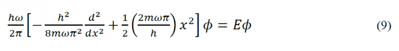

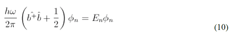

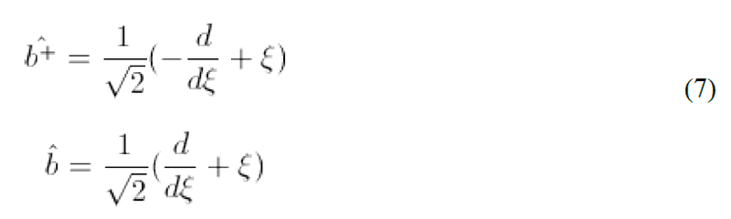

When I work out $$b^+b$$, I get
$$\widehat{b^+} \widehat{b} = \frac{1}{2} (ξ - \frac{d}{dξ})(ξ + \frac{d}{dξ}) = \frac{1}{2} (ξ^2 - \frac{d^2}{dξ^2}) = \frac{mωπx^2}{h} - \frac{h}{4mωπ} \frac{d^2}{dx^2}$$
So base on what I have about, (9) should be
$$(9) = \frac{hω}{2π} (\frac{1}{2} \widehat{b^+} \widehat{b} + \frac{1}{2} ξ^2)$$
instead of (10).
Am I missing out something?

##\frac{1}{2}(ξ-\frac{d}{dξ})(ξ+\frac{d}{dξ})=\frac{1}{2}(ξ^2-\frac{d^2}{dξ^2})##
The above step is not correct. Instead, it should be
\frac{1}{2}(\xi-\frac{d}{d\xi})(\xi+\frac{d}{d\xi}) = \frac{1}{2}(\xi^2 +\xi\frac{d}{d\xi} - \frac{d}{d\xi}\xi - \frac{d^2}{d\xi^2}).
Then simplify the second and third terms.

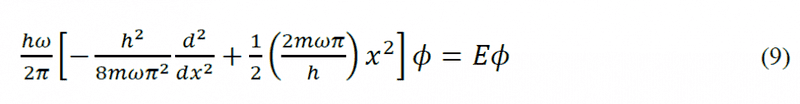

What about this one( $$\frac{h}{4mωπ} \frac{d^2}{dx^2}$$) which is supposed to be in equation (9)?
The only way I can get to $$\frac{h^2}{8mωπ^2} \frac{d^2}{dx^2}$$ is by multiplying $$\frac{h}{4mωπ} \frac{d^2}{dx^2}$$ with $$\frac{h}{2π}$$, which I don't know where to get from.
How I get $$\frac{h}{4mωπ} \frac{d^2}{dx^2}$$,
First, $$dξ = \sqrt[] {\frac{2mπω}{h}} * dx$$
Squaring it, $$dξ^2 = \frac{2mπω}{h} * dx^2$$
Subbing it into $$ \frac{d^2}{dξ^2} $$ from b+*b, I get $$\frac{h}{2mωπ} \frac{d^2}{dx^2}$$ before multiplying 0.5 from the bracket outside $$\frac{1}{2}(\xi^2 +\xi\frac{d}{d\xi} - \frac{d}{d\xi}\xi - \frac{d^2}{d\xi^2})=b^+*b$$.
TimeRip496 said:
The coefficient in front of the second order derivative in the above equation is not correct, as you can check its dimensionality. It should be
\frac{h}{4m\omega \pi}
which is the result you obtained from your own calculation. This is the correct one as you can check by multiplying it with the constant outside the square bracket and it should lead to ##p^2/(2m)##.

Thanks a lot again! One last thing if you wouldn't mind,
After converting equation (9) to equation (10),
$$\hat{b}*∅_0 = 0$$
Thus, $$\hat{b}^+\hat{b}*∅_0 = 0$$,
So equation (10) left with $$\frac{hω}{2π}(0+\frac{1}{2})∅_0=E_0∅_0$$
Shouldn't $$E_0=\frac{hω}{4π}$$ instead of $$E_0=\frac{hω}{2π}$$?
Doesn't the equation ##\frac{hω}{2π}(0+\frac{1}{2})∅_0=E_0∅_0## correctly imply that ##E_0=\frac{hω}{4π}##?
Yes, but from the source ##E_0=\frac{hω}{2π}##.
Source: http://vixra.org/pdf/1307.0007v1.pdf
I think you should look for another source to study this subject, the author seems to be rather sloppy with his derivation.
