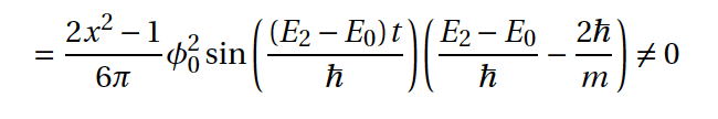

After looking at it, what leapt out immediately is the last factor your last equation
##\dfrac{E_2-E_0}{\hbar}## has dimensions of time ##[T]##
##\dfrac{2\hbar}{m}## has dimensions of ##[L^2T^{-1}]## which makes the factor dimensionally incorrect.
There is probably a mistake in applying the differentiation chain rule somewhere in there. I think that you could have simplified things a bit by using ##E_0=\frac{1}{2}\hbar \omega## and ##E_0=\frac{5}{2}\hbar \omega##. Then ##\dfrac{(E_2-E_0)t}{\hbar}=2\omega t## which is easier to handle.
Also, I would note that ##\Psi^*\dfrac{\partial \Psi}{\partial t}-\Psi\dfrac{\partial \Psi^*}{\partial t}## is the difference of a function ##f(x,t)=\Psi^*\dfrac{\partial \Psi}{\partial t}## and its complex conjugate and is therefore, equal to ##2i~Im(f)##.
Perhaps if you redid this slightly differently from the 4 times that you did it already, the problem will disappear.
Thanks. I find that if I set ##\hbar=m=1##, I get the right answer.
So you're saying that you should not have done this?
If so, it seems to me that elsewhere in your solution you implicitly assumed that ##\hbar=m=1## but I could not find where. Anyway, I think you're good.

The natural length scale for the harmonic oscillator is ##\alpha = \sqrt{\hbar/m\omega}##. If you change variables from ##x## to the dimensionless variable ##u=x/\alpha##, the Schrödinger equation becomes
$$\hbar\omega\left[-\frac 12 \frac{\partial^2 \Psi}{\partial u^2} + \frac 12 u^2 \Psi\right] = i\hbar \frac{\partial \Psi}{\partial t}.$$ Dividing through by ##\hbar \omega## gives you
$$-\frac 12 \frac{\partial^2 \Psi}{\partial u^2} + \frac 12 u^2 \Psi = i \frac{\partial \Psi}{\partial \tau},$$ where ##\tau = \omega t## is the dimensionless time variable. From this, you can derive the probability current ##j(u,\tau)## and show that ##\partial \rho/\partial \tau + \partial j/\partial u = 0##.

So ##\hbar=m=1## gets the right answer but the proper way to solve the problem is to define non-dimensional momentum and position operators.
I'll try deriving the probability current.
Probability density is given by $$\rho=\Psi^{*}\Psi$$
Using the product rule for derivatives gives $$\frac{\partial\rho}{\partial \tau}=\Psi^{*}\frac{\partial\Psi}{\partial\tau}+\Psi\frac{\partial\Psi^{*}}{\partial\tau}$$
From the non-dimensional Schrödinger equation, $$\frac{\partial\Psi}{\partial\tau}=\frac{i}{2}\frac{\partial^{2}\Psi}{\partial u^{2}}-\frac{i}{2}u^{2}\Psi$$ and $$\frac{\partial\Psi^{*}}{\partial\tau}=-\frac{i}{2}\frac{\partial^{2}\Psi^{*}}{\partial u^{2}}+\frac{i}{2}u^{2}\Psi^{*}$$
Substituting this into ##\partial\rho/\partial\tau## gives $$\frac{\partial\rho}{\partial\tau}=\Psi^{*}\left(\frac{i}{2}\frac{\partial^{2}\Psi}{\partial u^{2}}-\frac{i}{2}u^{2}\Psi\right)+\Psi\left(-\frac{i}{2}\frac{\partial^{2}\Psi^{*}}{\partial u^{2}}+\frac{i}{2}u^{2}\Psi^{*}\right)$$
The terms without the derivatives cancel out which gives $$\frac{\partial\rho}{\partial\tau}=\frac{i}{2}\left(\Psi^{*}\frac{\partial^{2}\Psi}{\partial u^{2}}-\Psi\frac{\partial^{2}\Psi^{*}}{\partial u^{2}}\right)$$
This is ##\frac{\partial J}{\partial u}## and leads to $$J(u,\tau)=\frac{i}{2}\left(\Psi^{*}\frac{\partial\Psi}{\partial u}-\Psi\frac{\partial\Psi^{*}}{\partial u}\right)$$
I hope I didn't screw up my derivation.
flyusx said:
So ℏ=m=1 gets the right answer but the proper way to solve the problem is to define non-dimensional momentum and position operators.
These are the same things. The non-dimensional operators are defined in such a way that it is the same as putting the constants to one.
