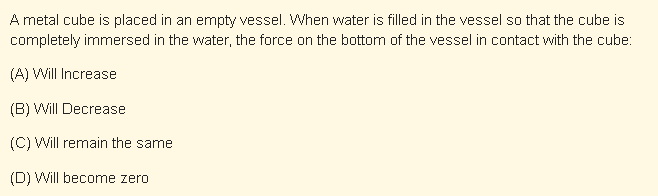

Please see the question :
Ans given is C) .
I believe all three A), B),C) can be correct under different conditions .
I think C) can only be correct under the assumption that no water enters between the bottom of cube and vessel AND water is filled just upto the height of the cube . If former condition is not fulfilled then answer would be B) . But if former is fulfilled and latter is not ( water is filled to a height greater than the height of the cube) then A) is correct .
Do you agree ??

What does your free body diagram on the cube tell you?
I have written my analysis on the basis of FBD of cube .Which part of my post#18 do you not agree with ?
I totally agree with your analysis.
