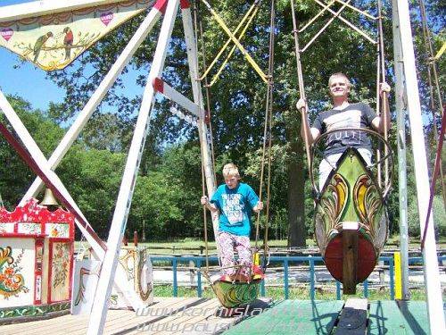

On fairgrounds in the Netherlands we used to have boat swings approx 16' tall. It was pretty easy to touch (almost ram) the canopy when standing on the thing.
I don't mean swing carousel but these:
