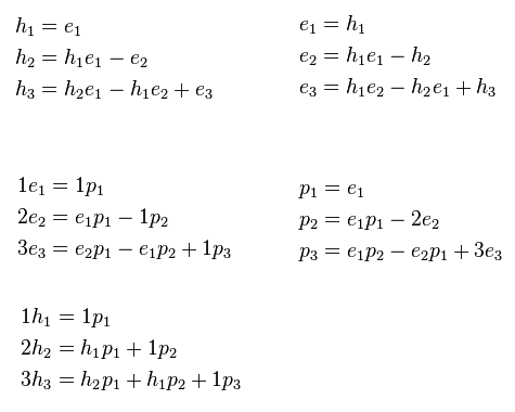

Look this relationship:
http://en.wikipedia.org/wiki/Newton's_identities#Related_identities
If I isolate the variable p, I'll have:
##p_1 = 1h_1##
##p_2 = 2h_2-h_1p_1##
##p_3 = 3h_3-h_2p_1-h_1p_2##
So, my question is: BTW, would be true that:
##p_1 = 1h_1##
##p_2 = 2h_2+h_1p_1##
##p_3 = 3h_3+h_2p_1+h_1p_2##
EDIT: I'm asking because with base in other formulas seems that there is some symmetry between the signals...
##p_1 = 1h_1##
##p_1 = 1h_1##
No.
The first equation just above is correct, but the next two aren't. You can' t just change the sign arbitrarily.
If ##p_2 = 2h_2-h_1p_1##, you can replace ##p_1## by ##h_1## to get
##p_2 = 2h_2 - h_1^2##
