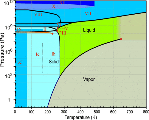

Something that is neat, is that the conditions around Phoenix hover right around the borderline between H20s solid and gas phase...
the average pressure was 8.55 millibars
http://phoenix.lpl.arizona.edu/05_27_pr.php
~8.55 millibars = 855 pascals
-30ºC = 243K
-80ºC = 193K
Pressure-temperature phase diagram of water on logarithmic pressure axis in Pa, with labelled solid ice phases (Ic, Ih, II, III, V, VI, VII, VIII, IX, XI, XII), liquid, vapor and a critical point regions.
I wish I could find more data on the pressure variation.

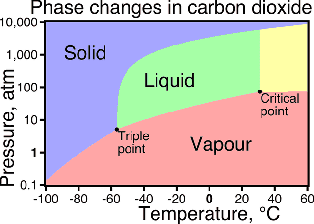

do they have one of those charts for co2?
hmmm- I wonder if those 'waterfalls' (on the sides of the cliffs on Mars), then, are some form of that very small possibility realm of some sort of outpouring of a CO2 'waterfall'?
Took a minute to find one with the same scales so it's easier to read.
Phase diagram of carbon dioxide plotting pressure in atm on a logarithmic axis against temperature in °C, with regions labelled Solid, Liquid, Vapour and a Critical point and Triple point marked.
Can't find one with pascals instead of atmospheres.:mad:
Strange. Google says 855 pascals = 0.00843819393 atmospheres. So, going by that last chart, there shouldn't be any solid CO2 at all in the area? In fact the pressure is waaay off from being close. I'm guessing exposed CO2 would evaporate immediately?
http://hypertextbook.com/facts/2000/LaurenMikulski.shtml
"The pressure of Mars's atmosphere varies with the season, ranging from 6 to 10 millibars (1 millibar is approximately one one-thousandth of the air pressure at the surface of Earth)."
well, the temps are right in the 'right' areas for CO2 to sublimate and crystalize most of the time maybe at the 'poles' and become liquid at Mars's temps too (maybe in the equitorial and 'temperate' zones
