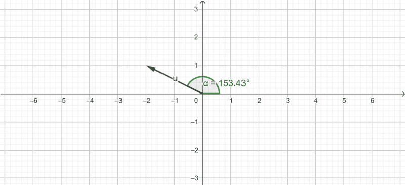

pbuk said:
I don't really understand any of that, but ## \arg(-2 + i) = \pi - \arctan \frac 1 2 ##.
Understood. Let's see if my drawing agrees with your quote. ##\pi-\arctan\frac 1 2 ##, could be ##\mbox{Arg}## of ##w=(-2+i)##, ##\pi## counterclockwise, and ##\arctan \frac 1 2## clockwise?
I don`t manage with ##\pi+\arctan(-2)##. I've tried with a Casio fx-82MS, pretending to switch polar to rectangular coordinates: I won't bore the forums with my effort; I just declare that my attempt is ##\pi+\arctan(-2)=-0.1\mbox{radians}##.
I post with no preview
Regards!
PS: Edited. Reason: Mistake when describing the Geogebra file.

Hi, PF, write to say how misled was I when saying that the ##\mbox{Arg}## corresponding to ##w=(-2 +i)## was ##\pi + \arctan(-2)=-60.29\;\mbox{degrees}##. Actually placing ##w## at the fourth quadrant :oldlaugh:
