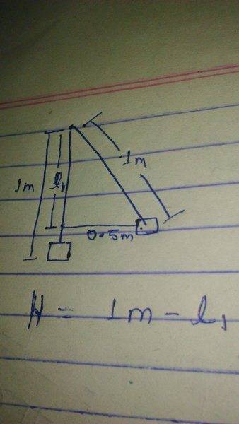

I'm sorry but I don't have the exactly problem written down but I know the givens.
So the question involves finding work done on a pendulum hanging from the ceiling.
I was given the the length of the string is 1m. That a mass hangs at the bottom of string and it's 2kg. That it displaces .5 meters to the left.
I was thinking that I had to do mgh = 1/2mv^2 but then did know how to get velocity.
Any clues?

Did you draw a sketch? What is the height of the mass at the end (and initially)?
Yes I've done the sketch. There was no given height! That's why I'm kinda a bit lost and confused.

But you have given mass displaced.5 meter and length of string 1meter from this you can calculate height
I'm not really recognizing how we can find height?
I don't think you have done the sketch properly. Draw the sketch and dimension where the mass is located.

Like this you can do
  • Handwritten sketch of a pendulum with a string of length 1 m and a block at its lower end, a second string of length 1 m to a block at the right with a horizontal 0.5 m offset, and a hand-written equation H = 1 m - l1 below.
Lori said:
There's no change in height?
You show the figure i have posted?
