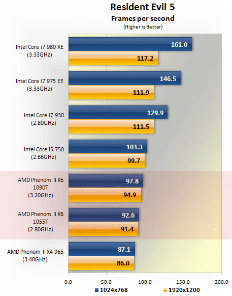

When it comes to games anyway (multithreaded or no), the i5-750/760 beats the Phenom II 1055.
http://www.techspot.com/review/269-amd-phenom2-x6-1090T-and-1055T/page8.html
