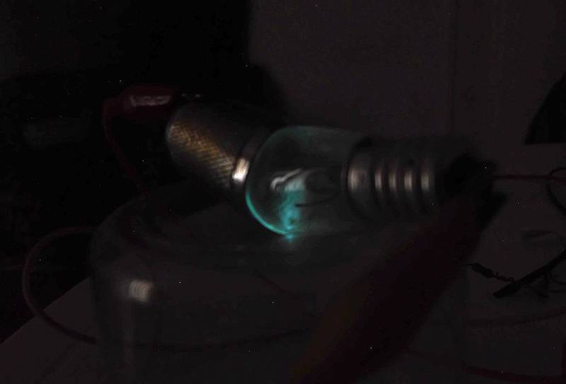

hi guys
i recently had built a HV power supply out of an old Flyback transformer i had laying around , i think it produces about 10KV ~ 15KV not very sure but it could arc at about ( 6mm in air ) ,
and as you can see i tried to connect it to a 15W smal light bulb ( the positive terminal is connected to the strange looking rod you see on the left which is just touching the glass ) and i saw that strange effect .
( i don't know but i think its just the highly energetic electrons exiting the glass molecules which causes it to flurecence ) , give me your opinion on what is this ?! and could this apparatus produce xrays ?!

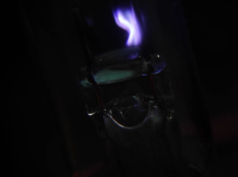

the argon glow discharge is very far of this color plus i have another gas tube filled with argon and it produces a purple discharge that's a photo of it :
the other glow is more of a yellowish green glow ( it doesn't seem to be glow discharge either ) its more like of a momentary flashes not a continios glow
another thing i have to mention is that the filament is broken and its impacts rapidly with the glass of the bulb could this be the cause or anything ?!
i just want to know these electrons are exiting what ?! because it doesn't seem to be the gas inside the bulb for some reason !

In the second picture you posted the color seems pretty close to the one I posted, :woot:
It is hard from the pictures to see where the light is actually coming from, does it look like it comes from inside the bulb?

yes! it comes from inside the bulb .
what really confuses me is that the glow doesn't match any of the nobel gases glow discahrge :
so , could this be from exiting the glass molecules or any thing ?!
i read some where that the yellowish green glow in the glass is somewhat an indication of xrays ?! is that correct ?
or i couldn't be producing xrays with relativaly low voltages ( 10 ~ 15 KV )

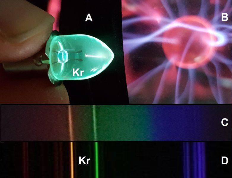

It looks somewhat like the glow discharge of krypton in the photo below. A special incandescent light bulb (A) filled with inert krypton gas is touching a plasma globe (B). A discharge occurs through the krypton gas in the light bulb, emitting greenish light. The spectrum of the discharge as seen by a hand spectroscope (C), corresponds with a krypton spectrum found on internet (D). Even the violet lines are present.
So you might get a stronger emission from your 15 W light bulb by holding it next to a plasma globe.

thank you spareine , krypton! i didn't see that one coming :) LOL
but i have a question : isn't krypton is much more expensive than argon to use it for filling a regular light bulb ?
Yes, the krypton light bulb cost about 2 euros, so it is more expensive than an ordinary bulb, but still within budget. :smile: I don't know whether krypton extends the lamp's life more than the cheaper argon, but I bought the krypton light bulb just for this experiment.
(I bought a xenon light bulb as well (same price), and its glow discharge emits a similar greenish light, but I did not succeed in seeing its line spectrum through the spectroscope.)

I don't think you have x-rays being produced in your light bulb. It is unlikely that the gas pressure is low enough - 10-3 to 10-4 Torr is required for soft x-rays and your bulb is likely to have a gas fill at about 80% of atmospheric pressure. You can certainly get x-rays emitted from a television tube if your anode voltage is high enough, probably 30 kV or so would do it. Have a look at this link for more info
http://www.belljar.net/xray.htm
Regarding krypton filled bulbs, I believe the switch to krypton was to allow a higher filament temperature and hence greater luminous efficacy than could be achieved with argon or a vacuum.
