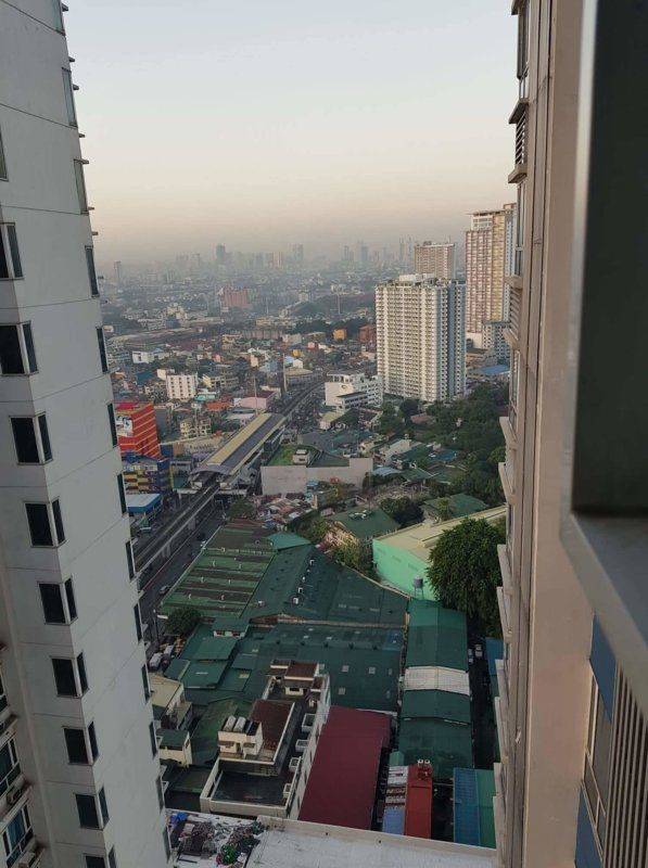

Mist or fog is said to be caused by water vapor while haze is caused by pollution. Every morning i got high pm2.5 readings in both my plantower 5003 and dylos testers which became half by midday. And humdity is high in early morning with haze (or is it mist) in the background of the city. This is taken at 6:18am.

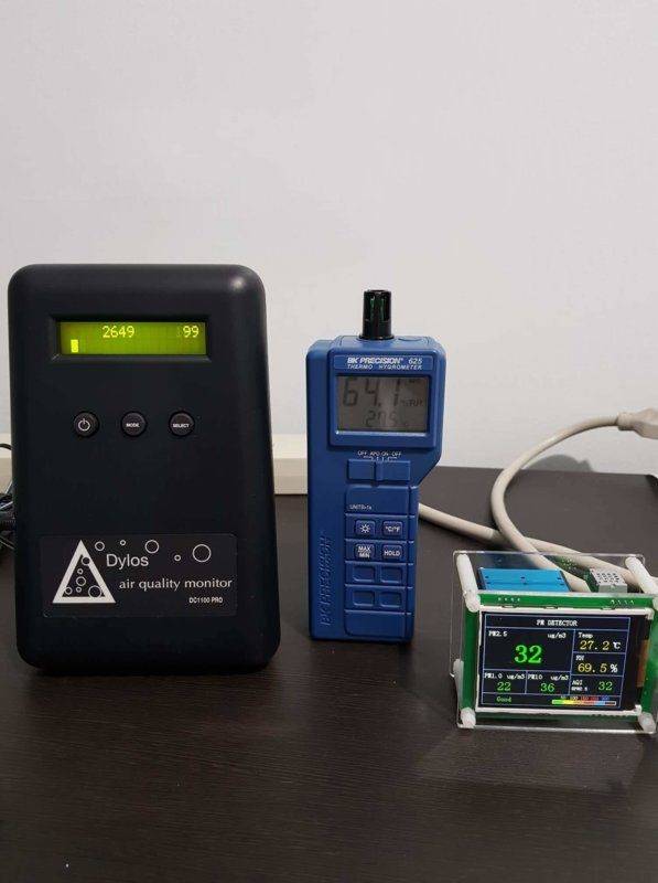

This is taken with my pm2.5 sensors and humidity meter.
I’d call it haze. Haze reduces horizontal visibility to about 10 km (7 miles) or less. Mist is usually already in the air in which you are standing, with relatively high humidity. Relative humidity in the morning hours tend to be high regardless of haze or mist because temperatures are lower.

I live in the 32th floor. Can mist gets as high as 32 floor? Doesnt mist also reduces visibility? In the picture earlier. Visibility is not affected to 10 km or less. How does mist look like when it covers whole city?

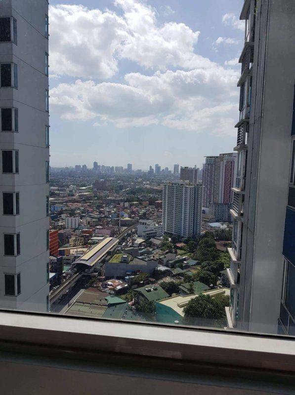

Here is picture taken same day at 1:19pm after noon:

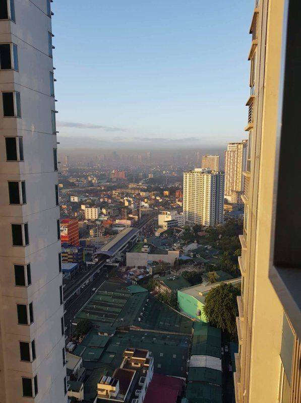

Here is the one taken same day at 6:18am early morning. Why did the haze or mist seem to gravitate during the night and gone as early as 10am? Where did it go?

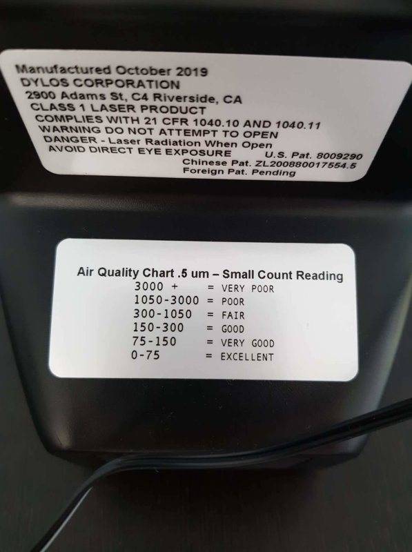

Here is todays mist or haze taken at 6:50AM. Its much worse than yesterday:
So its combination of mists and haze. But pm2.5 particles being 2.5 microns or less don't gravitate, so why don't they diffuse to the atmosphere above? I am still trying to confirm whether haze or mist is major portion of it so i can decide whether to buy an 60 sq. mtr air purifier.

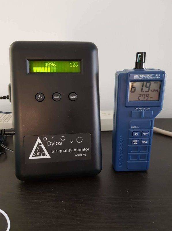

This is the particle counts accomplying it exceeding "Very Poor"
Value worse than "Very Poor"
I asked all this so i can know whether to buy an air purifier. Should I? I live in 32th floor. Look at the city picture. The sky is big. Why don't pm2.5 particulate diffuse away into the rest of atmosphere instead of getting in my unit at 32th floor?
This a typical phenomenon. At night the atmosphere calms down with the Sun no longer providing energy for upward mixing and turbulence. Everything concentrates close to the ground. A large amount of that haze could be vehicle emissions or emissions from asphalt plants (the worst!), electrical generation, open fires, etc. Humidity near the ground jumps when the temperature falls and transpiration/ground evaporation contribute to the high relative humidity. This layer hugs the ground, effectively trapping all that near the ground. Also notice the orange tint which could be due to NOx compounds resulting from high temperature combustion. Notice the complete lack of clouds which demonstrates the tranquil nature of the atmosphere. Good time to launch large billowy things like hot air balloons, btw.
Now look at the midday picture. The rising sun begins heating the ground and the air just above it. Warm moist air rises creating a bit of wind and turbulence mixing and diluting the pollutants in a thicker slice of the atmosphere; they appear to largely disappear. The top of this billowy turbulence produces those popcorn clouds when the warm and moist air meets a cooler drier layer aloft. By now you had better have landed your hot air balloon. It’s not fun bouncing around in all that.

The reason for that sharp demarcation in the photo of post 17 is an Inversion Layer. That's when there is a layer of cooler air above that traps the warmer air near the ground. Quite common here in the Southern California Summer. The warmer ground air is attributed to the City Effect, where all the pavement and buildings warm up during the day and keep the air warmer at night. At night here there is usually an on-shore breeze bringing the cooler ocean air in, trapping all the smog/haze below it.

I agree with some previous commenters that part of what is happening is an inversion layer in the early morning. As sunlight heats the Earth's surface, the temperature difference decreases, but also convection starts to mix layers, allowing fast-moving high altitude air to couple with lower layers, causing them to move faster as well. Sea breezes from land-sea temperature differentials might also be at play.
However, I would not rule out lighting effects related to geometry. In the early morning, sunlight is passing almost horizontally through the atmosphere, meaning that when it is passing low enough, it has a long path length right through the densest haze, giving it more opportunity to scatter. The haze, in effect, casts a shadow on itself. Whereas if you look more vertically, you are looking at light scattered from sunlight that has passed through a thinner part of the atmosphere with less haze and hence is stronger, but also is more likely to be scattered by air molecules than by larger haze particles, and thus the scattered light is bluer. The resulting color and intensity contrast between the haze layer near the horizon vs. blue sky above makes the haze more noticeable in the AM. Closer to noon, the sun is passing through much less atmosphere and less haze and therefore scattering less no matter which direction you look. This flattens out the contrast between the horizon and stuff above it, making it appear as if there might be less haze, when in fact there might be as much or more.
I would recommend relying less on your camera and more on your other meters to figure out whether there is a diurnal pattern in particulate counts.

But pm2.5 particles being 2.5 microns or less don't gravitate, so why don't they diffuse to the atmosphere above? I am still trying to confirm whether haze or mist is major portion of it so i can decide whether to buy an 60 sq. mtr air purifier...
2.5micron particles do "gravitate". The smaller the particle the more it behaves like a gas, but there is no firm cutoff where they no longer settle. A quick google tells me that the half life of 1 micron particles in a 2.5m high clean room with turbulent air have a half life for settling of 12 hours. That's pretty slow, but it is enough to say they won't disperse without help from the weather. A calm morning means no help. And when an inversion layer traps them (as others said), it's even worse.
So I don't see a conundrum here; believe your particle counters and get an air purifier.
