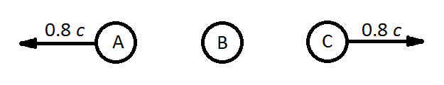

No, as Nugatory points out, it doesn't work that way. Another way to see this is to imagine a space buoy planted at the turn-around point. The buoy is "B" in this figure, and it's at rest relative to Earth.
A represents the ship after it has turned around and is headed back towards Earth. C represents what the ship would be doing had it not turned around but instead kept moving away from Earth. An observer on B would see both A and C departing at speeds of 0.8 c. But what about an observer aboard C?
To an observer aboard C, B would be moving away at speed 0.80 c. But A would be moving away at a speed of about 0.98 c.
Another way to calculate this is to use the relation $$\beta=\tanh \theta.$$ In this example ##\beta=0.80##. We don't double ##\beta## to get 1.6. Instead we double ##\theta## to get about 2.20, and then get about 0.98 for the corresponding value of ##\beta##.
