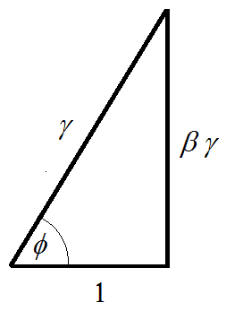

MachPrincipe said:
Quote: (from http://scitation.aip.org/content/aapt/journal/ajp/54/6/10.1119/1.14557)
"A ‘‘space‐time angle’’ φ is defined by setting v=c(sin φ). This leads to a form of Lorentz transformations which uses simple real trigonometric functions and yields a graphic correlation of important relativistic quantities for particles [...]
In that scheme ##\phi## is not an angle in the spacetime of special relativity. It's an angle in Euclidean space. All of the trigonometric relations presented in that paper can be derived from this figure. Namely ##\sec \phi=\gamma##, ##\sin \phi=\beta##, and ##\tan \phi=\beta \gamma##.
Note that the Pythagorean theorem is valid: ##\gamma^2=(\beta \gamma)^2+1^2##.
In the case of a triangle on a spacetime diagram we'd instead have ##\gamma^2 = (\beta \gamma)^2-1^2##.
Yes. The diagram would be euclidean, with +1 +1 +1 +1. The interpretation of relativity from this POV is referred to as Euclidean relativity.
The diagram I drew is in Euclidean 2-space.
No, it's the same relativity, it's just using an angle in Euclidean space to do an analysis of Einsteinian relativity.
You were discussing an angle between a space axis and a time axis when you brought up this angle ##\phi##. I was merely pointing out that the two are unrelated.
Yes, you are right. I was thinking of the more general 4d spacetime.
Yes, I agree. It's similar to Lorentzian relativity being equivalent to Einsteinian relativity. Still, if you look at the entry of Wikipediaa on alternatives to special relativity, you will. find that some advocates believe there are indeed differences. I think that is due to a misinterpretation of their own ideas.
Yes, the angles are unrelated as the diagrams, Minkowski, Brheme, Euclidean are all different. I was just guiding to the poster to ideas that could find close to what he is thinking of. And adviced to master on Minkowski ones, to avoid misinterpretation of more unconventional views.
