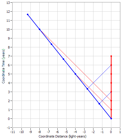

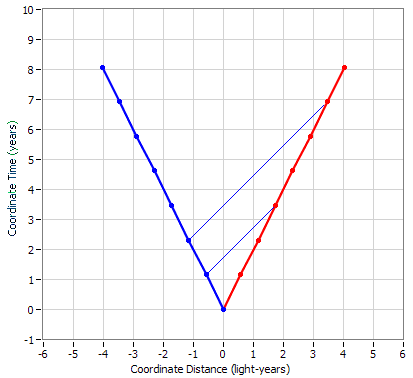

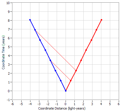

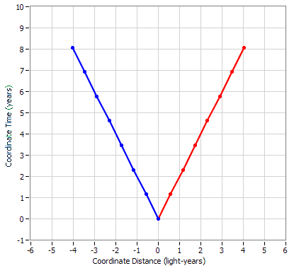

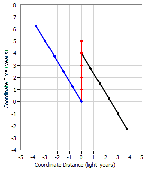

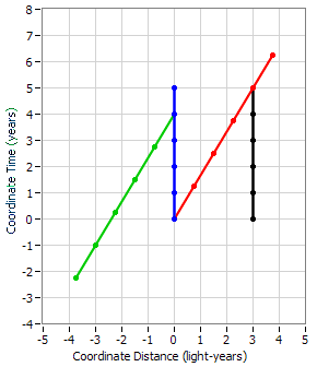

Time for some more spacetime diagrams to show you that Time Dilation is relative just like Velocity is relative to an Inertial Reference Frame (IRF). In this spacetime diagram, rock A is shown in blue, rock B is shown in black and ship C is shown in red traveling at 0.6c from blue A to black B. Since in this frame, C is traveling at 0.6c, its clock is Time Dilated by the factor 1.25 which means the dots marking off one-year increments of time are spaced 1.25 years of Coordinate Time:
As you can see, during the time that red ship C is traveling from blue rock A to black rock B, five years has transpired for A and B but only four years has transpired for ship C. But that's only true in the mutual rest frame of A and B. In other frames, the speeds of all objects can change and with them the Time Dilation factors.
To see this, we transform to the rest frame of the red ship C:
As you can see, the red ship C is not Time Dilated but the two rocks are Time Dilated.
As I suggested in post #4, you can make the scenario symmetrical by adding another ship D shown in green behind ship C and spaced the same distance apart in their mutual rest frame as rocks A and B are separated in their mutual rest frame:
If we ignore rock B, this looks just like a mirror image of the first IRF. We see blue rock A traveling from stationary red ship C to stationary green ship D in four years whereas both ships ticked off five years.
Can you see that Time Dilation is relative to your chosen IRF just like velocity is?
For completeness sake, we transform this frame back to the original IRF:
You commented that ship C had a higher velocity of the three bodies and I have already shown you that this is not true in the last two diagrams but now I want to show you that we can pick a frame in which all the bodies are traveling at the same speed (0.333c) and all of them are subject to the same Time Dilation:
For both red ship B and black rock A, it takes them each four years to reach their respective destinations, a completely symmetrical scenario.
Any more challenges for the notion that Time Dilation is not relative?
