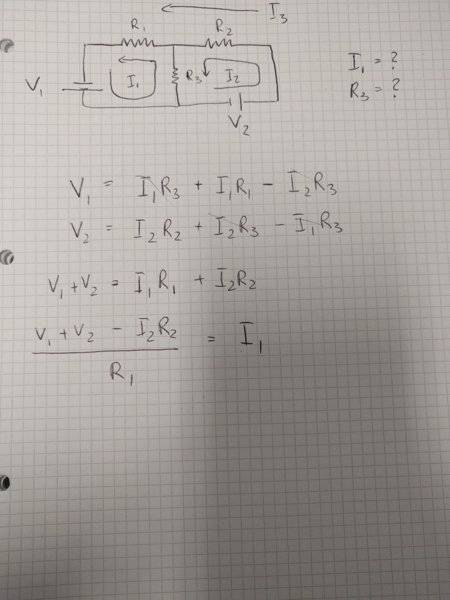

I am very comfortable with circuits but I did Walter Lewins courses after my first completion of Giancolis Book and then Ohanian.
I found his way to be much faster.
The Examiner asked me for I 1 (Current through the left loop) and R3 said all other things (I 2, R1, R2, I3) are known.
I told them (a physics teacher and a professor of chemistry were my examiners) that usually one would solve this by using Kirchhoffs loop rule.
But I know a faster way from youtube. The Examiner asked me to go ahead then and use my way.
But while writing my equations (same as Lewin in the Video) she kept saying I was wrong as I1 and I2 don't go through R3.
While I was actually just one step (a total of 3 away from solving).

i'm also going to make sketch now. But if you follow him my equations and the problem match exactly.
it's quite the coincidence
Update: Sketch
The above is basically the sketch I received.
https://imgur.com/a/R1kbJBf
I proved (With three similar problems from Giancolis book where we had numbers to work with) and the professor agreed that the result is "numerically" always correct. Just the way he insisted is wrong.
And at the beginning, until he saw that R3 wasn't given he also insisted that with Kirchhoffs rules we could have solved it in one step.

That works, sure. Just an application of Kirchhoff's laws. I don't see why you would use it in this case, however:

In my equation what they said specifically was wrong was the - I2 R3 part. in the first equation and -I1R3 in the second equation.

Add 1=1 as third equation.
No, seriously: If they asked for one specific way to solve it then you should use this method. Otherwise a large range of methods will work.
As yet another option for the problem given in the video: Introduce the unknown voltage V3 and make two equations based on V3 and I3 coming from the two sides of the circuit. Also two equations and two unknowns. Solving for I1 would take a bit more time that way.
You can also do a Y-Δ transform...
What is done in the video certainly works.

Yet in my equations: https://imgur.com/a/R1kbJBf they said that of V1 = I1R3 + I1 R1 - I2R3 the "-I2R3" part and in
V2 = I2R2 + I2R3 - I1R3 the "-I1 R3" part is wrong.

Try this as an exercise. Write the three equations as the examiners wanted. If you use the "small" loops, the two voltage equations would each have an I3R3 term; the third equation should be a variant of I3 = I2 - I1 depending on how you choose the directions of the currents. If you substitute this expression for I3 in the other two equations, you should get Levin's equations. His method is just a shortcut that does the substitution automatically. If you want to be successful at university, I suggest that you try to concentrate on understanding what you are doing instead of blindly following a recipe that you found on the web. True understanding comes when you discover and apply your own recipes and shortcuts that work just as well.

From what you have posted so far, you will not be able to convince him simply because he does not want to be convinced or he is already convinced, but will not admit it. Move on.

Here's a copy of the image rotated:
Handwritten circuit diagram with two loop currents I1 and I2 and a branch current I3, resistors R1, R2 and R3, sources V1 and V2, followed by loop equations and the solved expression for I1.
That method of dealing with the currents is a fairly common method.
You do need to be careful about signs. It looks like you have used "the sum of the EMFs in any closed loop is equivalent to the sum of the potential drops in that loop. Notice that in the direction of Loop 1 (marked with I1) the current through R3 is I1 − I2. in the direction of Loop 1..I would encourage my students to write the Loop 1 equation with I1 − I2 grouped as follows.
##V_1 = (I_1-I_2)R_3 + I_1 R_1 ##​
but there's nothing wrong with what you did.
In an oral exam, my view is that if the student can explain what he/she is doing and why they're doing it, that's more important than doing it in some strictly prescribed way.
