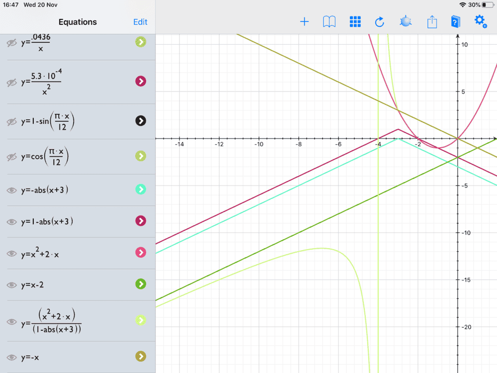

lim(x->-2) (x^2 +2x) /(1-abs(x+3))
setting the limit we get 2.
but plugging -2 you clearly get a 0/0 answer. which one is correct?
is x=-2 an asymptote?

The limit is of the form ##0/0## which is why it's non trivial to evaluate.
It's not an asymptote. It's simply the limit at ##x = -2##.
Remember - the limit as a function approaches c is a different concept than the value of a function at c. If you get an indeterminate form like 0/0 or infinity/infinity, you typically have to do some more math to evaluate the limit. In this case, try factoring, and take into account that the abs function is a piecewise function

What you have is a removable discontinuity at ## x = -2##.

It's fairly obvious that the function is undefined at x = -2. The whole point of evaluating this limit is to determine whether there is a removable discontinuity at x = -2 (a "hole" in the graph) or that the function's values become unbounded (go to ##\infty## or ##-\infty## -- a vertical asymptote).

it says y=x-2 is and y=-x is not. is it possible y=x-2 is an asymptote for x<-3 ? and vice versa?
For very large x, I get an oblique asymptote of y = -x. For very negative x, I get an oblique asymptote of y = x - 2, which agrees with what you have.
If x > -3, |x + 3| = x + 3.
If x > -2 (to omit the discontinuity at x = -2),
$$\frac{x^2 + 2x}{1 - |x + 3|} = \frac{x^2 + 2x}{1 - x - 3} = \frac{x^2 + 2x}{- x - 2}$$
Simply by factoring the last expression we can see that if x > -2, we get y = -x.

so we have 3 asymptotes.
x=-4 for x<-3 (obvi)
y=x-2 for x<-3
y=-x for x>-3
Just say x = -4 is a vertical asymptote. Don't add "x < -3".
Wi_N said:
y=x-2 for x<-3
y=-x for x>-3
The latter two are oblique asymptotes. Horizontal and oblique asymptotes have to do with the graph's behavior for very large or very negative x values.

As you show:
For ##x>-2## the function ## \dfrac{x^2 + 2x}{1 - |x+ 3|} ## is identically equal to ## x##.
So, for ##x>-2## the graph of our function lies directly on the graph ##y=x##. I wouldn't call that asymptotic behavior.
Not writing a waterproof complete explanation which would look more complicated than it is, but roughly on the graph of a function that contains abs if it has a zero and the same function without the abs is continuous, then the function will be continuous but have a kink in it, see blue-green curve in the attachment* at x = - 3.Then the abs incorporating into other functions can give you kinks at points which are not zeros, see dark red curve, which is our denominator.When a denominator is a zero and the numerator is also continuous and non-zero at that same point you have an infinite discontinuity, as you should already know, and as this illustrated in the jade curve at x = -4 which is our function, however if both numerator and denominator have a zero at the same point then usually the quotient will be finite there and continuous but kinked as here at x = -2.
These points are illustrated in the diagram, as also others discussed above, such as the asymptote and the special feature of this example, that for x > -3 , numerator and denominator have a common factor and the equation reduces to y = -x
*The equation for corresponding to each colour of curve is given in the last items in the list on the left, but take no notice of the preceding equations which are from other work that I did not manage to block out.
