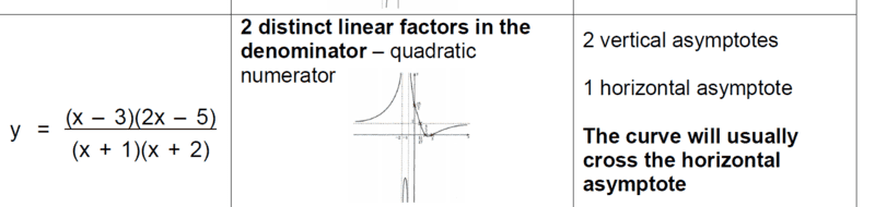

Consider,
Table row: y = (x - 3)(2x - 5) / ((x + 1)(x + 2)), with notes: 2 vertical asymptotes, 1 horizontal asymptote, and the curve will usually cross the horizontal asymptote; small sketch of a rational curve with vertical asymptote lines.
I am self-studying;
My interest is on the horizontal asymptote, now considering the degree of polynomial and leading coefficients, i have
##y=\dfrac{2}{1} =2## Therefore ##y=2## is the horizontal asymptote.
The part that i do not seem to get is (i already checked this on desmos) why an asymptote can be regarded as such if it is crossing the curve. In my small understanding, i thought asymptote ought not to intersect any curve or line...
For vertical asymptote, that is straightforward, solving the denominator, shall give me ##x=-1## and ##x=-2##.
Thanks

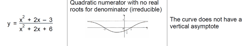

This is related to the original post;
Table with three columns: the rational function y = (x^2 + 2x - 3)/(x^2 + 2x + 6); the note 'Quadratic numerator with no real roots for denominator (irreducible)' above a small sketch of a curve with a dotted horizontal line at y = 1; and the text 'The curve does not have a vertical asymptote'.
What about the horizontal asymptote? ##y=1##? Now considering the fact that asymptotes can cross curves.
An asymptote is about how a curve behaves at infinity, not how the behaviour looks in some intermediate range. It does not matter at all if it crosses the curve or not. All that is relevant is whether or not the curve approaches the asymptote at infinity.

What about it?

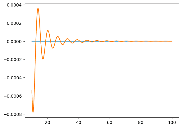

Another example, here is the plot of ##y(x) = \sin(x)/x^3##:
Plot of a decaying oscillating curve in orange against a flat blue line at zero; x-axis runs from about 10 to 100, y-axis from -0.0008 to 0.0004, with oscillations shrinking toward zero.
It has the asymptote ##y = 0## as ##x\to \infty##, but crosses the asymptote an infinite number of times.
Edit: Function in orange, asymptote in blue.

Noted, that is clear. I am now looking at how to determine the stationary points; either for local maximum or local minimum. To close this well, let me determine that and share ... considering the function in post ##1##. I have
##y= \dfrac{(x-3)(2x-5)}{(x+1)(x+2)}##
Let the graph meet the horizontal line ##y=k##
##k= \dfrac{(x-3)(2x-5)}{(x+1)(x+2)}##
##kx^2+3kx+2k=2x^2-11x+15##
##(k-2)x^2+(3k+11)x+2k-15≥0##
##(9k^2+66k+121)-4(2k^2-19k+30) ≥0##
##9k^2+66k+121-8k^2+76k-120 ≥0##
##k^2+142k+1 ≥0##
##k=-141.99 ⇒x= -1.441## will give us local maximum
and ## k=-0.007 ⇒ x= 2.755## will give us local minimum.
Cheers @Orodruin ... most math concepts I teach myself. Of course with great support from Physics Forums! Bingo!
