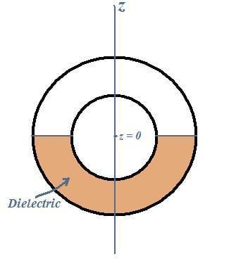

Two concentric conducting spheres of inner and outer radii a and b, respectively, carry charges +/-Q. The empty space between the spheres is half-filled by a hemispherical shell of dielectric (of dielectric constant ##\varepsilon / \varepsilon _0## ).
a)Find the electric field between the spheres.
b)Calculate the surface-charge density distribution on the inner sphere.
c)Calculate the polarization-charge density induced on the surface of the dielectric at r=a.

Couldn't Gauss make life a lot simpler here?
BTW the"spheres" are really spherical shells, especially the outer one, right?
Also, the problem doesn't state whether the dielectric is over the outer or inner section of the space between the shells.
Hello, rude man.
The setup is as shown.

P.S.:Sorry rude man if I posted no picture. :(

Oh right, P.S.:Sorry rude man if I posted no picture. :(
"No harm, no foul"!
