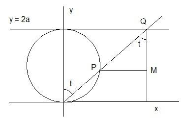

If P is any point on the circle C in the xy-plane of radius a >0 and center (0,a),let the straight line through the origin and P intersect the line y = 2a at Q, and let the line through P parallel to the x-axis intersect the line through Q parallel to the y-axis at M. As P moves around C, M traces out a curve called the witch of Agnesi.
For this curve, prove that it can be parameterized as W (t) = (2a tan t, 2a cos2 t). Fi- nally, use this parameterization to find a cartesian equation for the curve by eliminating the variable t.

Hello Janet,
Please refer to the following diagram:
Let point M be at $(x_M,y_M)$, and point P be at $(x_P,y_P)$
As you can see, we may state:
$\displaystyle \tan(t)=\frac{x_M}{2a}\,\therefore\,x_M=2a\tan(t)$
We may also state:
$\displaystyle \tan(t)=\frac{x_P}{y_M}$
$\displaystyle y_M=x_P\cot(t)=a\sin(2t)\cot(t)=2a\cos^2(t)$
I made the observation that:
$\displaystyle x_P=a\sin(2t)$ from the requirements:
$\displaystyle x_P(0)=0,\,x_P\left(\frac{\pi}{4} \right)=a,\,x_P\left(\frac{\pi}{2} \right)=0$
And so we have the parametrization:
$\displaystyle M(t)=\langle 2a\tan(t),2a\cos^2(t) \rangle$
Now, to eliminate the parameter to obtain a Cartesian representation of the curve, we may write:
$\displaystyle t=\tan^{-1}\left(\frac{x}{2a} \right)$
Now substituting into the y-component, we find:
$\displaystyle y=2a\cos^2\left(\tan^{-1}\left(\frac{x}{2a} \right) \right)=\frac{8a^3}{x^2+4a^2}$
