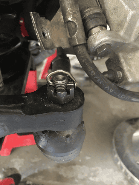

berkeman said:
Great video, thanks @DaveE
And "loose bolts"? The Cotter pins would have to have been missing for that to happen, no? I suppose if Boeing reused the Cotter pins after the reinstallation, they could have failed and allowed the nuts to back off, but I can't imagine the technicians reusing Cotter pins.
@Flyboy -- You aren't allowed to reuse Cotter pins during maintenance, right?
No, never.
You use a bent nail instead.

nsaspook said:
No, never.
... I swear to god I will murder someone if I caught them doing stuff like that.
