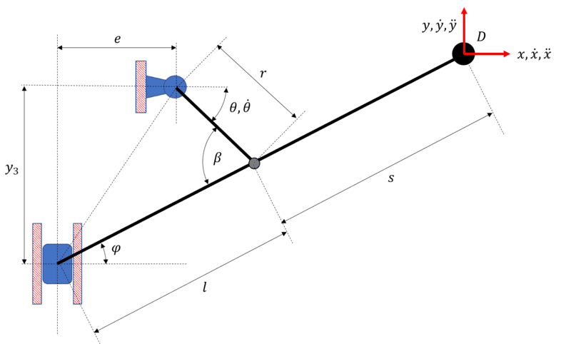

Hi, I was wondering if you could help me with a job at the university that consists of the kinematic modeling of mechanism number 3 in the image attached to this message.
I have to set up the constraint equations and then solve the position, velocity and acceleration problem. For now I would like to know if the equations that I have raised are correct, especially the prismatic pair, I do not know if I have done it correctly. The exercise is done in Spanish, which is my language.
Are you then after everything as a function of ##\theta_1##, ##\dot \theta_1##?
Sorry, I had a couple of errors in Pair R and in Pair P of point C. I'll send it to you again, let's see what you think...
Are you trying to find the output of point D as a pure function of the input ##\theta_1##?
Yes, I would like the independent variable to always be theta-1.
On the pair P, the angle restriction is that theta3 is always 90º. And then, I have made a simplification, that X3 is 0, since our teacher allows us to simplify the mechanism at our convenience

##\theta_3 \equiv 90°## doesn't make sense to me. You said you are after the position, velocity, acceleration of point D? If the angle I have labeled as ##\varphi## is ##90°##, the system is fixed.

The truth is that I am not very clear about what I have to do... I think I have to obtain the position, velocity and acceleration at all points of the mechanism. I am attaching the work guide to see if you can give me a hand.
Regarding the theta-3 angle, you may find it more meaningful considering that the slider does not have an eccentricity.

Sorry, I don't speak Spanish. If you don't know what you are supposed to accomplish I don't think I will be able to help much.
I'm imagining the link I have labeled ##r## is spinning with constant angular velocity ##\dot \theta = \rm{const.}##, I find what is the output of point ##D## given ##\dot \theta## to be of interest, but also very messy and much trig\calculus will ensue to get there. Perhaps that is because my methods are unsophisticated. I was going to solve for the ##x,y## coordinates of point ##D## as an explicit function of (##\theta, \dot \theta##), but maybe that is not necessary.
