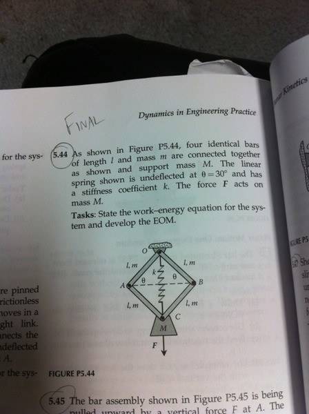

Please see the picture shown below:
I know the inertias of the AO and BO beams w/ respect to O are both 1/3*ml^2, but what are the inertias of AC and BC w/ respect to O?
Any other hints that you guys have for solving a problem like this? I'm using Lagrangians.
Thanks in advance

dillonmhudson: You might consider using the parallel axis theorem.
