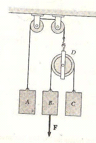

The discussion focuses on calculating force and tension in a pulley system involving three blocks with weights of 89N, 44.5N, and 44.5N. Participants derive equations based on Newton's laws and the relationships between the accelerations of the blocks, noting that the accelerations of blocks B and C differ due to the motion of pulley D. The correct values for the force F and tension T in the rope are determined to be 7.37 N and 92.7 N, respectively. The conversation highlights the importance of understanding displacement changes in the ropes and the role of acceleration in the system. Overall, the thread emphasizes the complexities of analyzing multi-pulley systems and the need for careful application of physics principles.
Apprentice123
92
The weights of the blocks A, B and C, shown in figure worth, 89N, 44,5 N and 44,5 N, respectively. The blocks are initially at rest. Knowing that B travels 2,44 m in 2s, determine (a) the module of F and (b) the tension on the rope AD. Discard the masses of the pulleys and friction.
Answer:
(a) 7,37 N
(b) 92,7 N
My solution
Block B
ZFy = mB . aB
T - F - mB.g = mB . aB
Block C
ZFy = mC . aC
-mC . g + T = mC . aC
aB = -aC
I can not find the answer of the book

Using the formula s = 1/2*at^2, find the acceleration of mb.

I have:
x = 1/2 * aB * t^2
aB = 1.22 m/s^2
Block B
T - F - PB = mB * aB
F = T - 50,034
Block C
-PC + T = mC * aC
T = 44,5 + 4,5361aC
How to calculate aC?
For block B, it should be
F + mB*g - T = mB*aB
Yes, thanks. How do I calculate aC?

General tip: if you can't see clearly what to do, then give everything names (or letters) :wink:
call the lengths of the ropes above A B C and D a b c and d, respectivley.
Then the height of B is -(b + d), also b + c is constant, and so is a + d.
Carry on from there … :smile:

Accelerations are vectors, and since the motion here is one dimensional one can add/subtract the various accelerations that the components in this system is experiencing. This also follows from Newton's second law, that is each force in the resultant equation for each mass has its own contribution to the resultant acceleration.
That being said one can see that D and A will share the same acceleration. D's acceleration is downwards in this situation. B and C would have had the same acceleration if it were not for the acceleration of D.
B accelerates downwards and C upwards. This mean that their common acceleration will be altered as follows:
The acceleration of D will subtract from their common acceleration for C and add for the acceleration of B.

rl.bhat said:
When you apply a force F on B, it moves down a distance b. It pulls A and C up with distance a and c respectively.
So b should be equal to a + c
Thank you rl.bhat.This is all that I needed to know.

I have observed a flaw in my post #18. Here is a new approach.
The given system contains two ropes. Each rope has two segments. when the force F is applied, all the segments will change their lengths. Note down the changes in the segments of a rope,and equate the net change to zero. Here we go.
When a force F is applied on B, the displacements of different masses and pulley D are:
B down by b, C up by c, D down by d and A up by a.
Now let us consider change in length of rope connecting Band C.
Since D moves down by d, both B and C will move down by d. Hence
net change in segment B = b-d
net change in segment C = -c-d
So the net change in the rope = b-d-c-d = 0. Or 2d = b - c.
And in rope connecting A and D, a = d.
Hence 2aA = aB - aC. Or aB = 2aA + aC
(F + mB*g - T)/mB = 2( 2T - mA*g)/mA + ( T - mC*g)
1.22 = 2(2T - 89)/8.9 + ( T - 44.5 )/4.45
= (6T - 267)/8.9
1.22*8.9 = 6T - 267
6T = 277.9
Tension in AD = 2T = 92.62 N.

You are applying the force to B. So the length of the segment B is increasing. There fore b should be positive. Similarly C is going up. So the length of the segment C is decreasing. Therefore c should be negative. Change of the length of the segment is measured as the final length - initial length.
anant,
Your accelerations aBD and aCD is the accelerations of B and C w.r.t. D, and since D is also accelerating these are not the resultant accelerations. Newton's second law states that the sum of the forces acting on a body is equal to the resultant acceleration times its mass, which is your accelerations aB and aC.
Also the accelerations aBD and aCD will be such that
aBD = - aCD

Since the movement of pulley D has no effect on the rope segment of B,shouldn't the change in rope segment of B,be b only?
Hi leena19! :wink:
I haven't really been following this thread, but the depth of B (below the ceiling) is Lb + Ld, the depth of C is Lc + Ld, the depth of D is Ld, the depth of A is La, and La + Ld is constant, and Lb + Lc is constant …
you should be able to work it all out from that. :smile:
(Lb is the length of rope between B and the nearest pulley, and so on :wink:)
leena19 said:
Forget my last post.I still don't get it :cry:
Even though the movement of pulley D has no effect on the rope segment of B, it affects the distance moved by the body. In the problem b is not the change in length of the rope segment. It is the distance moved by B. If D is not moving, then b is the change in length of the rope segment B.
In all such problems we have to follow five steps.
Step 1: Find out the number of inextensible ropes. For every inextensible rope there will be one equation.
Step 2: For every inextensible rope, find the bodies that are connected to the rope.
Step 3: To relate the acceleration between the bodies, assume that the various bodies move by a distance x1, x2, ...and so on.Calculate the number of segments in the rope.
Step 4: Relate the distance moved. (Total change in the length of the rope must be zero.) To do these calculate the change in length of each segment of the rope. Then add these changes to get the total change in the rope.
Step 5: Once we get the relation between the distances moved, the acceleration relation will be the same.
