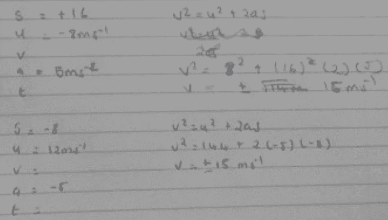

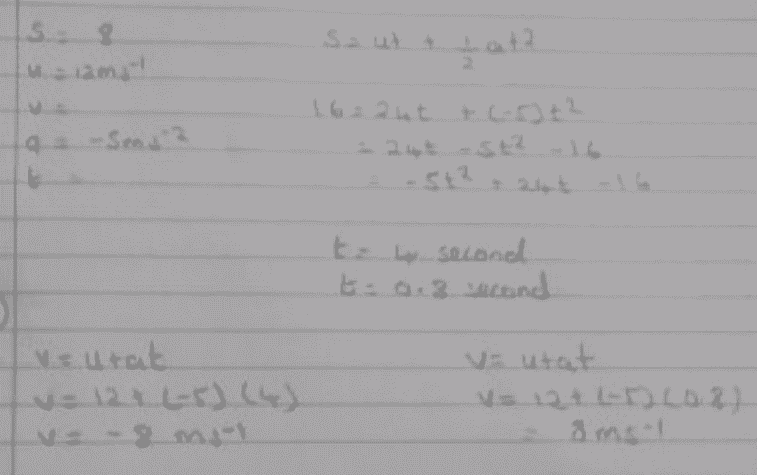

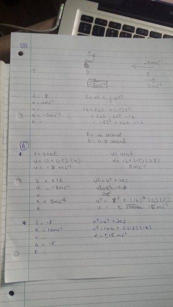

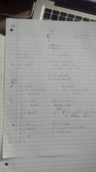

I have a question on kinematics, it is the second part of the question, there are two ways of doing the question the first way is straight forward ( one with ink writing ) but in the second method, the displacement is negative. Should it not be positive displacement? If it is negative displacement I will get into a complex number which we do not want.
Someone, please help me.
Thanks.
The question and my method will be attached to this post.

Also, we prefer that you include your work directly in this pane, not an image of your work. Although your work is fairly neat, the image is so small that it is hard to read (at least for me).

Easy for whom? How can helpers point out or quote lines of your work if it's all in an image? And the work has no comments to say what each step is meant to accomplish. And I'm sure that your handwriting is clear enough to you, but others may find otherwise especially if their viewing devices are not optimal (say a small tablet or phone).
Also, your "problem statement" image depicts two problems. You haven't identified which of the two you are working on.

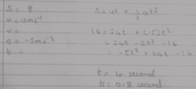

Your first image is helpful. It's clear and easy to read. It would have been more helpful had you indicated which problem you were solving.
Regarding the image of the hand written solution, as Mark stated,
and it's also hard for me to read.
But since you're new here, I viewed the image in its own window allowing me to zoom in. When I do so and get it large enough to read comfortably, the image is so fuzzy that its readability is only slightly improved.
Your first method:
Your second method:
First of all, if this is the method used to solve the same problem with the same given information, then use the same known data.
The real problem with your execution of this method:
The reason you get "complex solutions" is that the acceleration is in fact negative. You have it being positive.

Thank you, Sam, for your help. you have solved my problem. I will follow the procedure next time.
