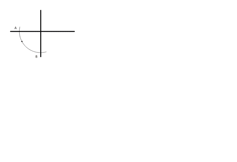

A mass slides down a segment of a circle starting from rest at A. It has a radius of R. Find the speed of the mass at the bottom ignoring friction. Also, find the time for the ice cube to go from A to B.
As far as solving for the time I am told not to calculate the integral but plot the function and estimate the area below the curve.
I attached an image of the diagram I am provided.

I believe the first part is simple. I can use the conservation of energy to find v because I know that at A there is no kinetic energy, it is all potential. The opposite is true at B.
.5mv2=mgr
.5v2=gr
vf=[itex]\sqrt{2gr}[/itex]
What I am having trouble doing, because it has been a while since the section on circular motion :-p, is relating v and t. v in the form I have expressed it (vf) is a constant so it doesn't really help me find t.
Any suggestions on a next step? Thanks!

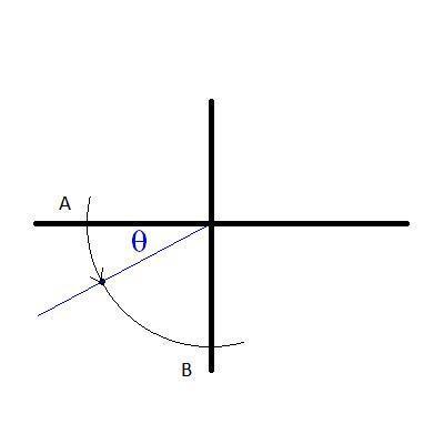

If you choose θ as shown in the figure changing from zero to pi/2, and initially both KE and PE zero,
1/2 mv^2-mgrsinθ=0.
ehild

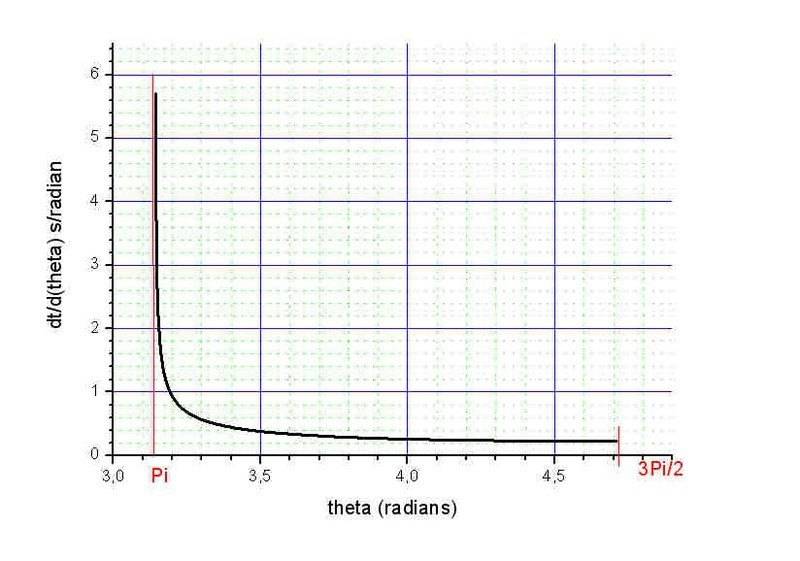

You can choose r=1, and plot y=dt/dθ=(√(2g)√(sin(θ))-1, in terms of theta in radians. Then estimate the area under the curve.
ehild

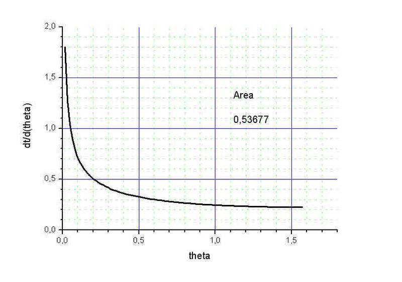

If your theta is between pi and 3pi/2 then sin(theta) is negative, and its square root is complex. The change of PE is mgsin(θ) then, and you need a minus in front of sinθ under the square root.
The formula for dθ/dt refers to the setup I have shown in my post#11, where theta goes from zero to pi/2. I plotted it out for r=1 from (almost) zero to pi/2, and integrated. The scale on the horizontal (theta) axis is in radians and the vertical axis is dt/dθ in second/radian-s.ehild

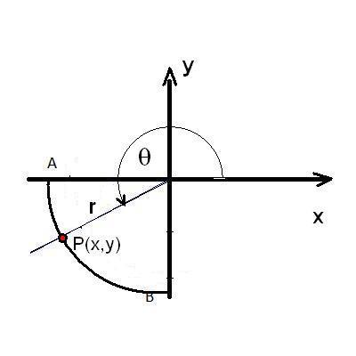

You are right, it is wrong. If you count theta from the positive x-axis as shown in the attached figure, the position of the mass at P is x=rcosθ , y=rsinθ.
Both cosθ and sinθ are negative, as P is in the third quadrant. When θ increases, y gets more negative and the potential decreases as the mass moves downward. If you take the potential energy equal to mgr at point A than it is
[itex]U=mg(r+y) = mgr(1+sinθ)[/itex]
at point P and zero at point B.
Conservation of energy means that
[itex]1/2 mv^2+mgr(1+\sin\theta)=mgr[/itex]
Rearranging the equation, mgr cancels and you get [itex]1/2 mv^2+mgr\sin\theta=0[/itex]
Isolate v: [itex]v=\sqrt{-2gr\sin\theta}[/itex], when θ changes from pi to 3pi/2.
oddjobmj said:
Also, I guess once I do end up with an estimated area under the curve I could just give the answer in terms of r by multiplying the variable r by the area, correct?
Lastly, I still don't understand why this form works for the estimation. dt/dθ is basically ω(t)-1. What is this plot representing? I'm sure I could get the answer correct at this point but I really want to make sense of it before moving on.
v is the speed and v= rω=rdθ/dt. So [itex]d\theta /dt = \sqrt{-\frac{2g}{r}\sin\theta}[/itex]
θ(t) is function of the elapsed time, t. It is monotonous function in the range where pi≤θ≤3pi/2. The inverse function t(θ) exists in that interval and its derivative is dt/dθ, the reciprocal of the derivative of θ(t).
[tex]dt / d\theta = \frac{1}{\sqrt{-\frac{2g}{r}\sin\theta}}[/tex]
The integral of dt/dθ from pi to 3pi/2 gives the elapsed time when the mass moves from point A to B. The area under the plot t(θ) between pi and 3pi/2 gives the elapsed time.
Note that r is under the square root. You can rearrange the equation to see how the time depends on r:
[tex]dt / d\theta = \frac{\sqrt{r}}{\sqrt{-2g\sin\theta}}[/tex]
ehild

Ah dang, my estimate is way off then. I'm getting the area is about .483 but using mathematica's NIntegrate I get 1.835.
The previous value you got was not accurate enough, but it had sense as an estimate.I used 1000 points to draw the curve. I do not know what Mathematica did. But you can not use Mathematica for the integration.
Just plot out the function and do the "integration" by counting the "tiles" under the curve . (Or cheat and use Wolframalpha to check yourself:-p) The graphical integration is difficult as the function tends to infinity at the lover bound.
I got abut 0.58 for the area.
ehild
