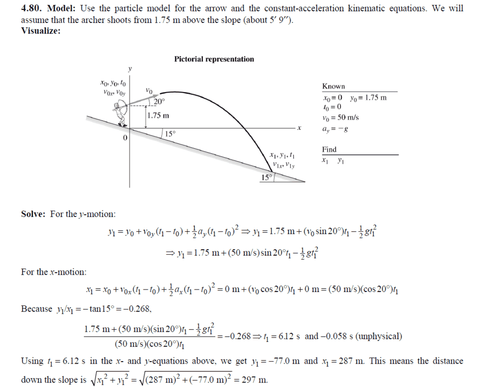

Is it possible to solve this problem by changing the coordinate axes?
Kinematic equations
Hi folks,
See below for a solved question finding the down slope distance of an arrow. How easy would it be to solve this question by making the x-axis the slope direction?
One way to find out is to do it ! You'll have acceleration on two axes.
Aha, yes horizontal acceleration is what I didn't consider.
