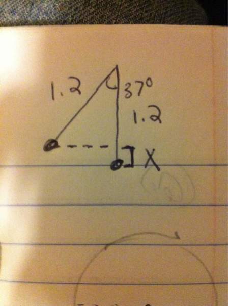

A simple pendulum is constructed by supporting a .375 kg steel sphere by a thin string 1.2 in length and of negligible mass. The pendulum is released form rest at a position where the string makes an angle of 35° with the vertical. What is the speed of the sphere as it reaches the lowest point of its arc.
KE= 1/2mv^2
PE=mgy
I attempted to find the potential energy when it is at the top of its path and then ,since it will have the same amount of energy at the bottom, find the velocity using the formula for KE (air friction I believe is not taken into account). I unfortunately don't know how to find the height of the sphere based on the angle from the vertical.
Draw a picture and use Geometry/Trigonometry
Do I have to use circle geometry? If so what is the relationship between the y distance, the radius, and the vertical angle?

Use trigonometry to come up with that.

if angle B was 35° then ##a## would be (c)(cosB)
Hope that helps
What I tried to do now was to make a right triangle and do 1.2 cos theta to get the upper distance and then subtract that number from 1.2 to get x. I still got the wrong answer.
The correct answer is .323 m/s
That's the right method. Please post the details of your working.
1.2 cos 37 = .958
1.2 - .958 = .242
mgy = .889
1/2mv^2= .889
v^2 = 4.74
v = 2.18

It isn't 37.
I still am not getting the correct answer even though I am using 35°. It still comes out larger than the answer.

OK I have figured out this problem the reason I got it wrong the first time with trig is because I forgot to convert inches to meters. It turns out you don't have to do any rotational KE or find the radius of the sphere. Thanks everyone for your help!
