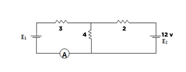

find the value of E1 that would make the reading of the ammeter = 0
I3 = I1+I2
E1 = 3I1 + 4I3
12 = 2I2 + 4I3
244826

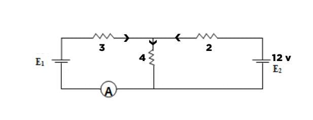

the question is find the value of E1 that would make the ammeter reading = 0 ?
i tried KCL , and KVL and got the following equations : ( I1 belongs to 3 ohm , I2 belongs to 2 ohm , I3 belongs to 4 ohm ):
I3 = I1+I2
E1 = 3I1 + 4I3
12 = 2I2 + 4I3
but now i have 3 equations in 4 variables ?!
i think its simpler than that but i am missing the idea here , any help on this ?
i saw the answer it equals 8 v , but i can't get any further with my equations .

Don't think of this as a system of ##n## equations and ##n## unknowns that you have to solve. You want ##I_1## to be zero, so get an equation involving ##E_1##, ##E_2## and ##I_1## by eliminating the other two currents and see for what value of ##E_1## the value of ##I_1## is zero. Alternatively, set ##I_1=0## in your equations and solve a system of 3 equations and 3 unknowns. You can do that in your head.
Another approach: You know that the ammeter reading is to be zero. So assume that is the case and simplify your equations accordingly.
But you know the value of one of those variables from the desired solution (ammeter current = 0).
thank you so much once you said I1 = 0 it hit me , i calculated it and it came out 8 v .
