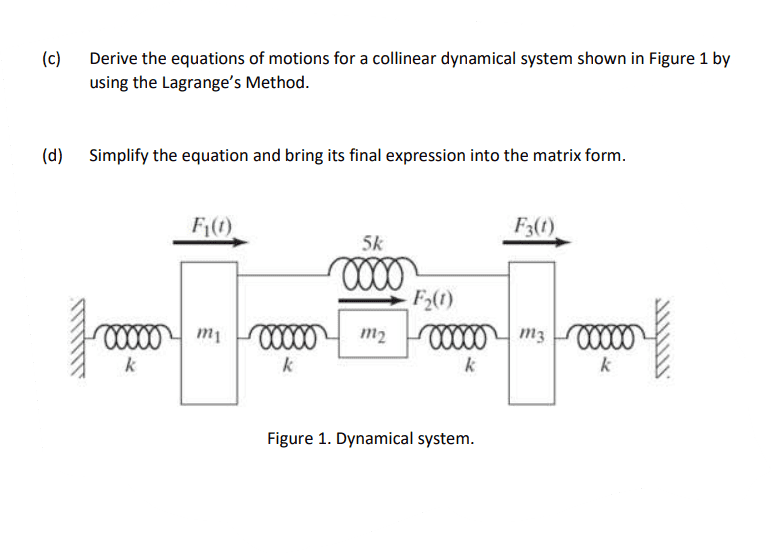

Derive the equations of motion using lagrange method
##V_sys=V_(g,sys) +V_(e,sys)##
Lagrangian## L=T_(sys)-V_(sys)##
Diagram of a three-mass spring system in a line between two walls, with springs labelled k, 5k, k, k and masses m1, m2, m3, forces F1(t), F2(t) and F3(t) shown as arrows.
I am working on problem c and I'm not sure if I'm doing it right, please can you help me understand if I am on the right lines? I want to get a better understanding of lagrange method problems

The figure says k1=k2=k4=k5=k. k3=5k.

We need wall to wall distance, say L and natural length of the springs which are L/4 and L/2 for thin m bodies though they are not clearly shown in the problem statement.

Your k1 and k5 springs are fixed on the walls. Coordinates of the walls are necessary to calculate their force and potential energy. Say they are 0 and L,
0<x1<x2<x3<L.
Say L-x3-natural length of k5 spring is positive, pull , and is negative, push.

The figure you posted shows 4 springs with value k and one spring with value 5k.
Okay so when doing calculations ##k_3## would just be written as ##5*k_3##?
